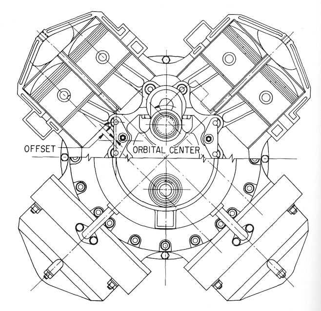

I believe Thiokol came up with an 8 piston cross shaped engine with four pairs of parallel pistons (sort of # shaped) but I'm unable to find much about it.
I'd love to know a bit more about it.
The only reference I could find relating to a piston engine from Thiokol is the "Dyna-Star." You'd have to pay $33 to learn more.

As for the Dynastar, these photos are not from the web, but there is plenty of information out there about it, but again the thread seems to have diverged from worst to "interesting" engines.
