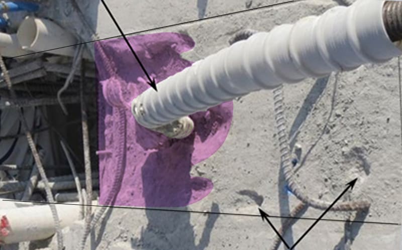

Here is one more piece of the puzzle. Member 11 was standing on its toes, so to speak, squeezed into the crook of 12 and the deck. The deck was being pulled opposite 11/12 by the sagging structure though unable to move far. It still supported 11. 12 was bowed north, while buttressing 11.
The following image may actually show the footprint or contact area of 11 on the slab, an indication of the role shear lag played in the redistribution of forces through 11. The redistribution is attributable to the myriad of inclusions isolating 12 from the deck and the underdeveloped theory that the innermost slab tensioning would catch the horizontal truss forces. Regardless of the cold joint, even solid concrete would have opened up around the fringe of the deck/11 interface.

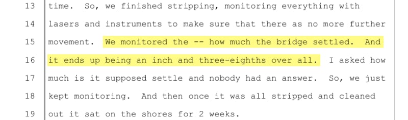

Also, the bridge did sag. I don't have the reference to this transcript excerpt (I clipped it out a while ago) ...
As they retensioned the lower bar, a more sinister situation develops. If there is any shortening between the upper and lower endpoints of the retensioning bar, tension is lost and the hydraulic jack pumps more energy into the system as tension is their only measurement. Eventually the uncontained longitudinal rebar in 11 pop free and 11 no longer exists, the bottom three feet are crumbled. The kinked upper tension rod and patterned rebar failure are evidence of 11 kicking out. The deck, 12, and diaphragm are still in tact at this juncture.

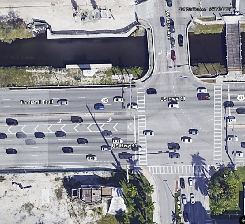

And, speaking of hubris. I do fail to see why the federal government should provide $20 million (according to the video) to build that bridge. It was completely unnecessary, as there was, and still is, a protected crosswalk approximately 50 feet away:
Who asked for money for this bridge? Who decided it should be given? It would be interesting to read the proposal submitted to the feds.
