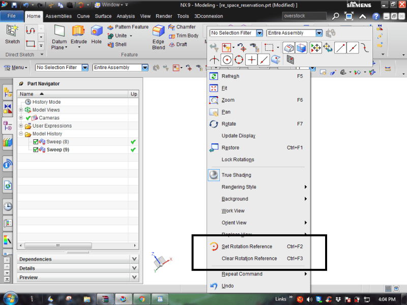

It is called "Set Rotation Reference" You can find it in the "View Shortcut" menu

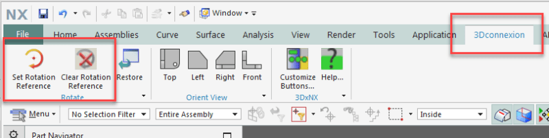

With NX active you start the settings panel for your 3Dmouse. There should be (in NX) a Ribbon tab available for this.

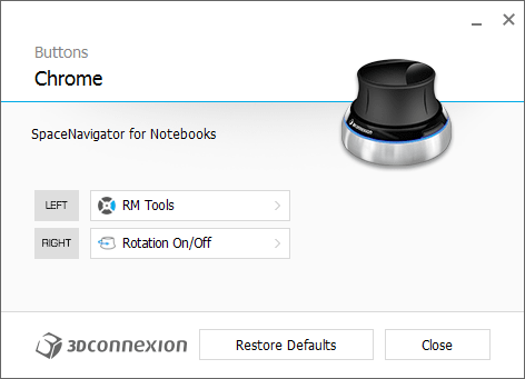

Unfortunately, my spacebsall is different than yours, an older model......I use it for my Catia projects, not for NX...........
It doesn't have the option I've been looking for........(It has only "Rotation On/Off")..............

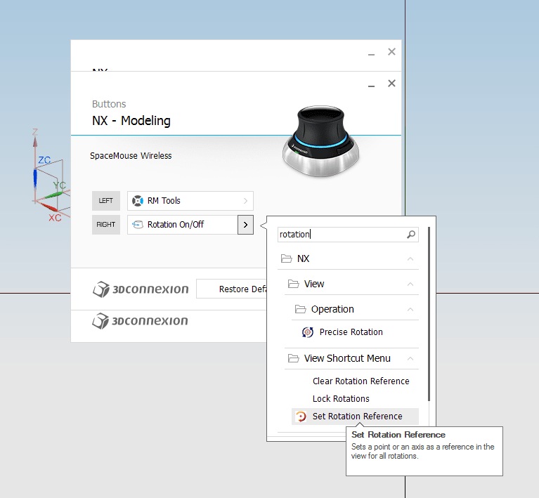

CAD2015
In your pictures Power point and Chrome is active application so you won't find this setting. Make sure NX - Modeling is active application see NutAce picture.

You should also have this option in a toolbar / tab in NX ( depending on the NX version)
This is NX10:
