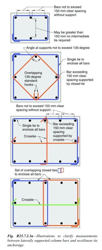

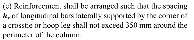

ACI does require bars on the sides for the earthquake resistance clauses, but it's phrased more around the need to provide an additional column bar to limit the spacing of ties for confinement across the section to a max spacing of 350mm. Refer to CL18.7.5.2(e):-
Surprisingly there is no similar provision for structures "not subject to earthquakes" if there is even such a structure. Which is pretty scary in terms of the lack of confinement the detail Ingenuity posted actually affords along the vertical sides (not to mention the 90 degree hooks ACI uses in the cover concrete, but don't get me started on those!).
Axial loads require confinement under gravity and seismic conditions, it has nothing to do with the moment only being about one axis. Like I said, very surprised to note this to be honest in ACI, thought the above applied to all structures, coming from somewhere with much more onerous confinement criteria it seems like an omission, but obviously shows some intent by the code authors that this good detailing only applies to structures subject to earthquakes.

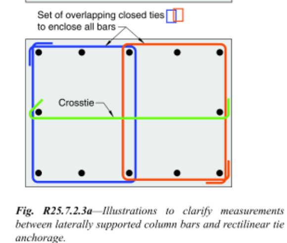

On looking a little further CL25.7.2.3(b) contains some further limitations on spacing of cross ties.
I find this quite odd, as it's saying you don't need to put in intermediate bars on the sides for example at all, but if you do you need to ensure they are confined in a fairly robust way (for confinement and anti-buckling). But they are ok with a poorly/partially confined core of concrete otherwise which seems very odd to me as an approach.
I'm curious for those designing regularly to ACI, whats stopping you putting 4 bars in any column at any size in the corners as long as it provides the strength in moment/shear....??? Seems like something is wrong if this is the intent?
These requirements are more like what is in the NZ standard, which I'm used to.
Agent666, good study but it still suggest that if you use a tie then you can still just use longitudinal bars around the corners right?

I'm of the opinion that
should not be used because you want the rebar cage to be fairly 'rigid'... not provided by dual 'cages'.
