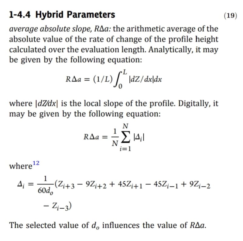

Hi all,
I have a component that will have a sliding surface and it is important that the surface quality is good to reduce the frictional forces as much as possible. I used this document: Link, to get some more information on how the surface roughness affects the coefficient of friction and one of the things that they conclude is that the average slope of a profile affected the coefficient of friction the most.
To my question, I was wondering if it is possible to define the average slope of the profile in a drawing under a surface texture symbol or should I just use standard GD&T symbols to control such a feature? I have never faced a problem like this one before and I am not quite sure if I can specify this or if I should just keep to the normal ways to specify surface texture. Your help and insight is greatly appreciated!
Best regards
According to ASME B46.1-2019, there is a parameter called "Average absolute slope, RΔa".
I would suggest checking in the manual of the device that will be used to evaluate the surface texture if an output value of this parameter can be generated.
You can call it out on the drawing just like any other parameter that is not Ra, per the ASME Y14.36 rules (if you need help with that too - ask).
Some info on it from the standard:
Z(x) is the roughness profile's height function (X is along the evaluation length).
