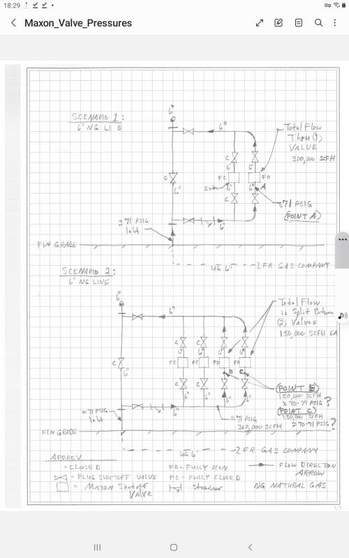

Hello,
I have an application for natural gas (NG) of Scenarios 1 & 2.
All 6" diameter Sch 40 Carbon Steel piping in the system.
Please see attached Maxon_Valves_Pressures.pdf for your clarity.
Scenario 1:
Have a 6" NG main line coming in from the gas company to a plant via a parallel set of Maxon shutoff valves. 2 total.
(1) Maxon is fully closed, (1) fully open. See attachment.
391,700 SCFH @ 71 PSIG from gas company main incoming line.
NG total flow at "Point A" will be 391,700 SCFH and a pressure of approx 70.5 PSIG (taking into account friction losses thru strainer, plug valves, & 90 deg elbow).
Scenario 2:
Once again, 6" NG main line coming in from gas company to a plant via two parallel sets of Maxon shutoff valves. 4 total.
(2) Maxon valves fully closed, (2) fully open. See attachment.
I'm now splitting the total flow between (2) Maxon valves.
Still 391,700 SCFH @ 71 PSIG from gas company main incoming line.
NG flow at "Point B" and "Point C" will be 195,850 SCFH each.
My 1st Question: Will the pressures at Points B & C still be approximately 70.5 PSIG with the flow split in-half into each Maxon??
If not, what ballpark PSIG will it be at Points B & C?

Q1, Yes, probably a little more pressure, maybe 70.6 or 70.7.

Why does your text sat 391.7/195.850 MSCFD and your diagram 300/150?
In your first scenario, there will not be a very noticeible change. The reason for that is as follows. Halving, or doubling something already very, very small, the pressure drop across completely open valves is next to nothing, is not likely to have any noticeable change in results.
Two same-size valves set at the same position essentially doubles the flow area and decreases pressure drop across the valves. Since the valves are fully open, pressure drop in that case is already very small, so decreasing something already small only makes it very small, so there will only be a very insignificant change to pressure drop and you can assume upstream and downstream pressures will remain approximately the same, but that would not be true if the valves were, say 75% closed and were introducing a large pressure drop. If you double the number of valves with a high pressure drop you might see only 25% of the previous pressure drop and that might make a significant change in flow rate. Depending on how the system responds to that flow rate increase, both upstream and downstream pressures might rise, or fall and the only thing you could say with any certainty is that they would both be 75% closer together than they were previously. You would have to know the pipe hydraulic boundary conditions and the response of any equipment to the change in flow rate. A compressor upstream might drop its upstream flow rate and discharge pressure, causing pressure to reduce everywhere in the system. A downstream boiler feeding gas at near 0 pressure would probably try to continue to do that higher flow rate at near zero exit pressure, in which case upstream pressure would have to increase in order to keep the same flow rate. If it did not increase, then the flow rate would drop.
Please remember that you have made this a special case by specifying that the valves were open to begin with. Halving, or doubling a very tiny pressure drop is not likely to have any noticeable change in results.
There is very little change between pressures and flows in reasonably balanced piping configurations and well balanced configurations. Reasonably balanced meaning all configurations have the same diameters and paths of approximate equal lengths. As long as the headers are 1.25 to 1.5 x the run diameters, you can feed and take from any header end, or feed and take from the middle, or any combination thereof with no real significant difference in flows through any run. Of course perfect balance is best, but seldom absolutely necessary.
In 6" Sch. 40 at 391,700 SCFH I get a pressure drop of 0.9 psi per 100 feet and velocity of 95 ft/sec. So the frictional loss is not significant to significantly affect the pressure drop between the two different configurations of the two different scenarios.

The path with the tee connection will have the highest pressure drop. Since this is pressurized pipe versus gravity flow I don't think the fractional psi loss in one path versus the other will have a significant effect on flow through each path. But if you really want to totally equalize flow then just make all connections tees and put a blind flange or cap at the end of the supply header.
