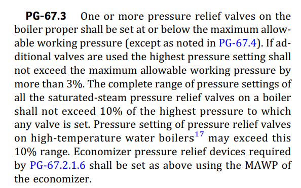

According to ASME-I, 'The Set pressure has to be at or below the max working pressure. If more than one safety valves are used, the max set pressure shall not exceed max working pressure by 3%.'. In addition, there usually is already a margin between normal working pressure and max working pressure.
But at low pressure boilers there is little cost difference if you keep max working pressure little above normal working pressure (say 5-7%). But you need to design the whole system for this. So you get 5-7% margin in pressure before simmering starts.
For smaller boilers it is very unusual to have ERVs(electromatic relief valves) and the simmering problem is usually taken care of by this way.

3% is the OVERPRESSURE for ASME I above the SET PRESSURE.
Operating pressure in this post is already established and commented upon.
You can't just 'jack up' a set pressure of a safety valve without first consulting the suitability of the installed springs range of pressure. Increasing set pressure also changes sizing and capacity of the safety valve.

@LittleInch,@Obturator,
There was an error in my reading of code and I have corrected the same. But my main point was to have set pressure and max working pressure above the normal working pressure which is normally done to avoid simmering.

Goutam freelance Your corrected post is still incorrect. For multiple safety valve installation, the overpressure can be higher for the additional valves acc. to ASME I.

@Obturator, pl see the image.
First and second sentences are clear.
Regarding third sentence, suppose your boiler max working pressure is 5 bar and you set the lowest set pressure as 4.6 bar (it is permitted as first set pressure is at or below the max working pressure) then you can not set the max set pressure above 4.6+0.1x4.6=5.05 bar (you can not use 5.15 bar using second sentence). But here this may not be relevant as we have only 1 safety valve.
The fourth sentence is also not relevant as this is not a high temperature boiler.
Hope this clarifies the matter and mistake was only once.
That's better. My point was in case of more than one safety valve, the supplementary safety valves can have a set pressure of 3% higher, meaning
1st valve set at MAWP.
2nd (or last valve) set at MAWP x 1.03
This was not made clear for other readers from your pre edited post Although your extract is correct, it is from the an earlier edition of ASME I (Currently 2019). I'll leave the post now as comments are now diverging from the original question.
