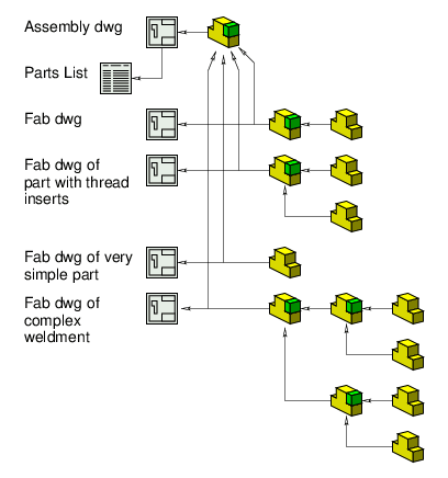

Jste,
I keep thinking about this. It sounds like you are installing SmarTeam as your PDM. SmarTeam is an expensive and powerful piece of software. I especially like the folders. Like 3D[&nbsp;]CAD, it is not the least bit idiot resistant.
I did the following diagram twenty years ago. I was not aware of SolidWorks' weldment feature, possibly because it had not yet been implemented, but that does not matter. There are any number of reasons and ways to attach a fabrication drawing to an assembly model.
This is how SolidWorks looks to me. I was designing mostly aluminium parts for devices to be mounted in aircraft, so I needed thread inserts. Unless I was absolutely certain my part would be absolutely simple, I created it as an assembly. For the complex weldment shown, the fabrication drawing would be sent out to a subcontractor. On the BOM (called Parts List) shown, I have no interest in the parts attached to the assembly models linked to my fabrication drawing. There are only four items on my BOM.
My figure does not show a sub-assembly. A standard thing to do with BOMs is to "explode" them, showing the contents of the sub-assemblies. SolidWorks does this, but not very well. Your ERP people will want to do this. If you sent then BOM files which they enter into their database, they can identify which items are sub-assemblies and do the "explode". If they expect the SolidWorks model to do it, you will be restricted in your use of SolidWorks.

drawoh,
We currently use Solidworks PDM for managing all CAD files. We have no plans to move away from it, despite the limitations it has at times. I like to think Dassault put their B-Team on PDM development so I'll excuse the poor documentation and confusing terms they use.
What I'm doing is using the generated BOM features built into SW PDM and then using CADLink to push part lists and BOM structure up to Netsuite. See here for their site: We're using CADLink because our quality / mfg team wants the ability to verify changes to metadata before the items get pushed into our ERP database.
Your image above matches how we do configuration / BOM control. It looks like SmarTeam is legacy PDM software for Catia? I would guess it functions quite similarly to SW PDM. The main difference is for purchasing (not for assembly and engineering) we skip the drawing and go straight to a parts list. It allows for our purchasing team to create orders for an entire top level or any of the various subassys if they desire. CAD Link also identifies assys automatically or I can mark assys as "purchased" if I happen to create an assy to mimic a COTS purchase we don't try to order the child parts.
