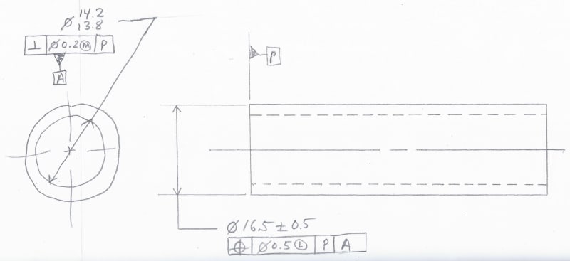

Question for the group":
(Ref: ""maximum wall thickness at one spot" vs. "maximum consistent wall thickness." from a previous discussion)
How the stackup -minimum and maximum wall distance- change (if it does ) , IF I would say that:
X maximum = maximum possible distance that can ever happen in a single cross section for cases.
x minimum = minimum possible distance that can ever happen in a single cross section for cases.
Will those two values of 2.35 and 0.65 for the maximum wall distance and minimum wall distance respectively, change with my above adjustment?
If yes, what would be the "new" values for X maximum and x minimum?
Thank you very much

This is an academic discussion only and RSS and no-RSS is really irrelevant on what I am asking.
This is a case from Alex Krulikovski (Stackup book)--as you can see is quite old book (written probably in 90's per 1994 standard), but the concept and what I am trying to learn from this discussion is still valid and conceptually unchanged.
Again, my questions are:
How the stackup -minimum and maximum wall distance- change (if it does ) , IF I change a little bit the definition of what X maximum and x minimum means:

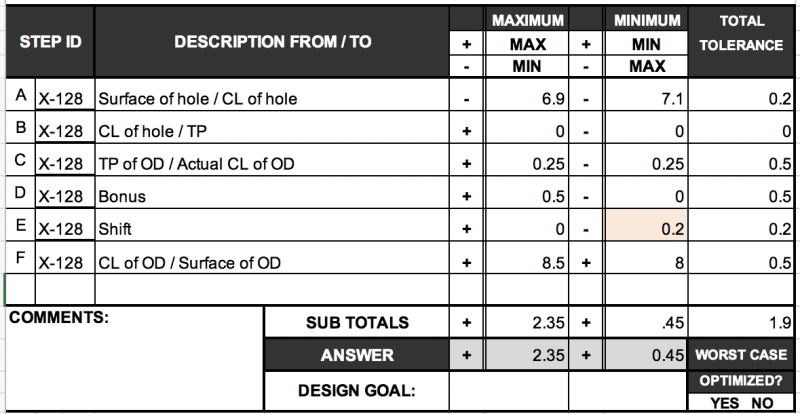

That I was thinking too. The answers should be the same: X max .0205 no matter A is RMB or A is MMB.
Do you agree with my above statement? If you plug the values in your spreadsheet did you get the same numbers regardless if datum feature is called RMB or modified at MMB?

If your question is what I've quoted here, then I presume you meant to type 2.35 rather than .0205?
If so, then the max stays the same. The min would change, however, because having MMB on the datum causes a shift tolerance to appear only in the min column:

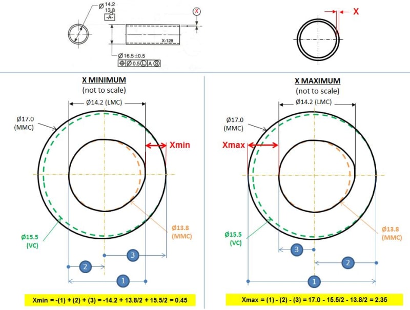

For this discussion I got the same value like yours for x minimum (0.45), but for X maximum I got 2.6.
Belanger said:
However, that's just talking about RMB versus MMB. But is that related to your question about cross-section vs. consistent wall thickness?
Ignore RMB versus MMB (that is applicable to the other thread). But you know what, could be applicable here too. Again, even in this thread if A is RMB (as originally is shown) or you change it to MMB, IMHO the two values of X maximum and x minimum are not changing. Do you agree with that? i hope you do. If not, let me know.
Now regarding X maximum = 2.6 (my value) I got it from:
17.0/2 + (0.1+1.5)/2 -13.8/2 = 2.6
Lets reconcile my X maximum value as this looks like I am not really understanding on why yours is only 2.35.
So, J-P, in your opinion onyl X minimum will be different if the question is changed from consistent wall thickness to cross-section?
X maximum stays the same?

In this thread, let's say that Krulikowski changed the circled S to a circled M. I showed the max as staying the same (2.45) but you got 2.6.
Where does your 0.1 come from?
Since the only change is the MMB modifier, are you thinking that the datum shift is 0.1? I see the total shift as 0.4 (eventually cut in half) but that doesn't apply in the max column because datum shift is only felt with the datum feature departs away from max material (thus I plugged 0.4/2 it only into the min column).

I think you are correct here: I have added another 0.1 (2x 0.5) by mistake.
The middle term should have been only 1.5 which comes from 0.5 (initial positional tolerance value ) + 2 x 0.5 (bonus from departure from LMC = 1.5
So, I agree with you J-P, that the correct calculation for X max is
17.0/2 + (0.1+1.5)/2 -13.8/2 = 2.6 2.35
Therefore only x minimum will change if we change the problem from "consistent thickness" vs. "thickness at one spot."
Do you also agree that datum feature modifier on A is irrelevant for our case? I mean joggling between MMB and RMB on "A" will not make any difference for the "thickness at one spot" case? In other words X maximum and x minimum values stay unchanged.
(Those values of X maximum and x minimum will change if A is called LMB, but that in entire another case)

If we assume that the part below is produced perfectly straight, can the picture for X minimum be qualified as an illustration of consistent wall thickness?
Thanks, pmarc -- a picture certainly helps. Yes, I would call that consistent wall thickness because that Xmin could run down the full length of the part (longitudinally). However, I stand corrected on one thing; while I arrived at that min by adding MMB, it can also occur in the RMB case when there's form error.
