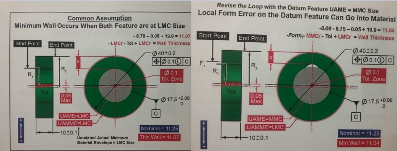

Here it is a picture from a training material I got few years ago.
You can see there, is shown the difference between "thin wall" 11.07 and "min wall" 11.04.
Per my understanding, this is the difference between consistent thickness case 0.45 and consistent thickness case 0.65
Based on my latest sketches, do you agree that if datum feature C is changed at MMB -- C(M) -- those two values (11.07 and 11.04) will NOT change?
Please let me know, what do you think. If the values will change, then why ?
Yes, that's pretty much the same idea that pmarc was showing (which I agreed with). I just disagreed with your usage of the terms consistent vs. one-spot. Recall that your initial question in this thread was asking about "maximum (and minimum) possible distance that can ever happen in a single cross section." Given your latest pictures, I would agree that the minimum is the picture on the right (11.04). I was seeing that minimum as "consistent" throughout the depth of the feature.

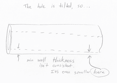

I guess that's where we diverged in our terms. Now look at my hand sketch from July 24; I was envisioning even more reduction in the minimum if we also consider any depth-wise tilt of the hole. So I apologize for muddling the terms... you brought up a good point about the original Krulikowski calculation, and from there I went down a different road with the one-spot thinking.

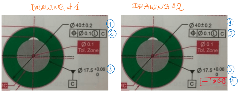

Assuming it is a rigid and non-stock part, is there any difference between the two drawings below? To me, they are identical. So the OB should be 17.62 for both. But based on the Y14.5 standard, OB = 17.56 (left), and OB = 17.62 (right). Am I correct? If so, I think maybe ASME should consider changing the definitions for LMB for size tolerances with no geometric tolerance where Rule #1 applies.
Also, maybe the new Measurement Data Reporting standard can formulate this, so it is measured. What I mean is, if you have 3 ballons, you would only have 3 line items in your stack-up (let's say, you wanted to know the minimum thickness in a measured part, and you wanted to put in the measured values).
For what I know the LMB for both drawings posted (Drawing #1 and Drawing #2) is 17.62.

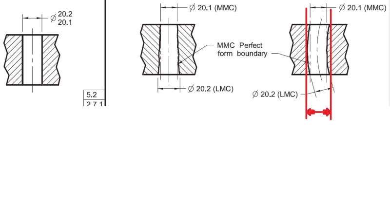

Just to justify my previous post, I would ask what is the size boundary (LMB) shown in the embedded picture--between those two red arrows?
Isn't it: 20.2 + 0.1 (20.3) ?
If not, why not? Then what it is?
