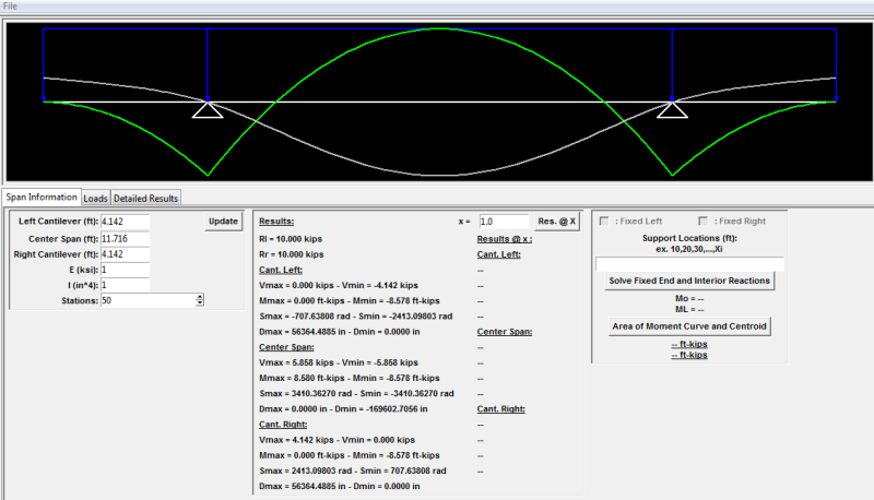

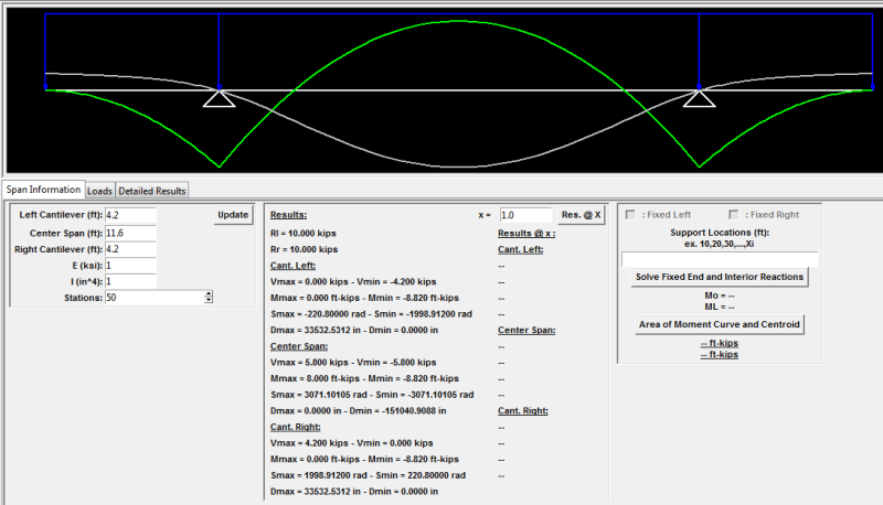

I get deflection results pretty close to BAretired's numbers
with E= 1 ksi, I= 1 in^4, L=20ft, w= 1 klf
@0.21L for the cantilevers an upwards deflection of 0.000121 w L^4 / EI
@0.2071L for the cantilever an upwards deflection of 0.000204 w L^4 / EI
0.21L - grey=deflection green=moment blue=load:
0.2071L:

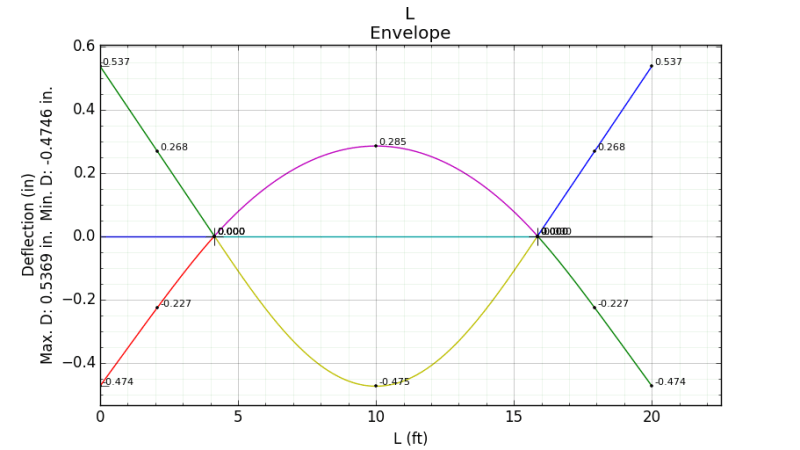

If anyone is curious for the envelope deflections
Take the numbers in the attached image * 29000 * 30.8 / (1* 20^4 * 1728) = c
delta = c * w L^4 / EI
Edit:
This covers the following patterns with 1 = loaded span
1,1,1
1,1,0
0,1,0
0,0,1
0,1,1
1,0,0
0,0,1
1,0,1

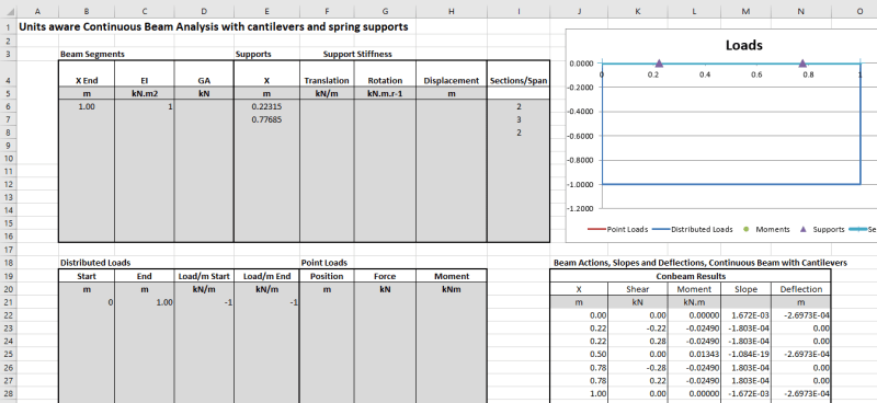

Open Source Structural Applications:

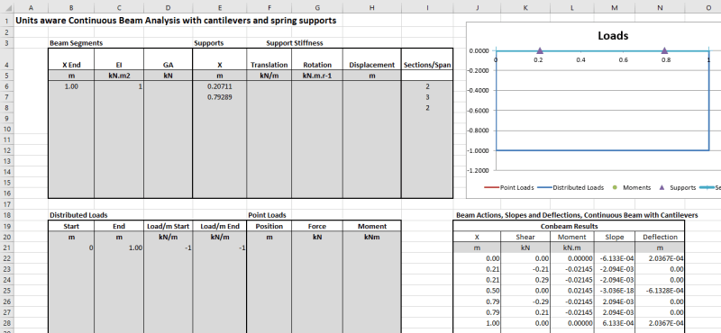

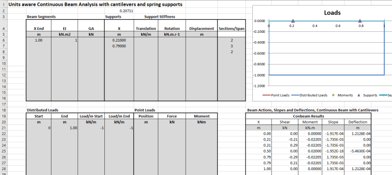

Spreadsheet results using:
ConBeamU
With L=1, EI = 1 and load = -1 in any consistent units:
With Cantilever = 0.21:
Cantilever deflection = 1.2128E-04, Mid-span deflection = -5.463E-04
With Cantilever = 0.20711 (to equalise moment magnitude at support and mid-span):
Cantilever deflection = 2.0367E-04, Mid-span deflection = -6.1328E-04
With Cantilever = 0.22315 (to equalise deflection magnitude at support and mid-span):
Cantilever deflection = -2.6973E-04, Mid-span deflection = -2.6973E-04
Doug Jenkins
Interactive Design Services
