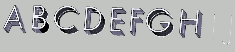

Hi all,
Need some help please.
I have got these stick fonts into a sketch (as polylines) but can't get them to pocket in the part.
I have also tried projecting them onto another sketch to create geometry but this wont work either.
Using 'thicken' some of the letters/numbers pocket but most won't.
Can anyone tell me how I can get them to pocket because I'm totally stumped :(
any help would be really appreciated.
thanks
Alan
Hi LWolf,
I have attached a part file. (R27)
Sketch Two is the polylines copied from a .dxf
Sketch Three is the polylines projected to create geometry.
I just can't get either to pocket and can't work out why.
thanks
Alan
I succeeded generating a B...
after some work though. In your sketch (btw, you don't need any other support but xy-plane) right-click on the B-polyline and explode it...
use then Sketch Analysis to see the result, and you will see that there are doubles, and sometimes even 4s of the lines... sooo: if you make sure there is NO overlapping lines in your profile, it will be possible to make it into a pad :)

thanks LWolf,
I have managed to do a couple by doing what you suggested.
Is there a an easy way to delete the overlapping lines or is it a case of 'one at a time' ?
I've always used standard fonts that don't seem to have any issues but the NC guys want a single line font to engrave.
I was hoping to be able to give them the sketch to engrave with and also pocket it to show on the model and drawings.
I'll keep trying
much appreciated you pointing me in the right direction :)

I have succeeded getting it done...
in GSD (shape design) make a projection of your sketch onto XY plane (type normal), no nearest solution, no smoothing. Keep all subelements.
in GSD, do a disassemble-INTO domains
in GSD, join curves forming a letter into one join
in a sketch, project this join.
I was able to generate A-H, in a rather quick way.
