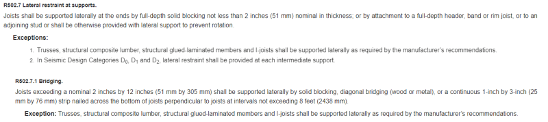

The argument would be that steel beams aren't in the IRC. The element has to be fully designed by an engineer under the IBC or another alternate provision. So they should get that document.
Also, the IRC has king posts for every type of header and similar individual beam type element that it covers.
Also, these are the lateral support, movement and uplift clauses it isn't compliant with.
