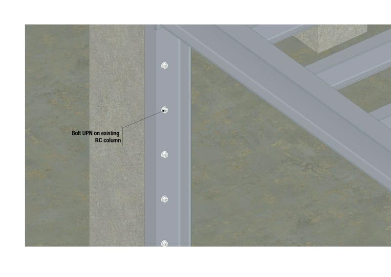

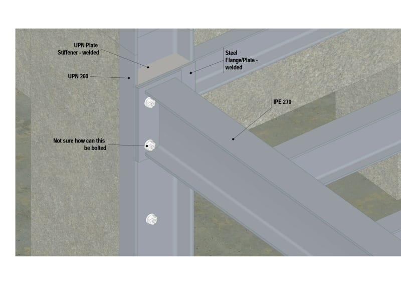

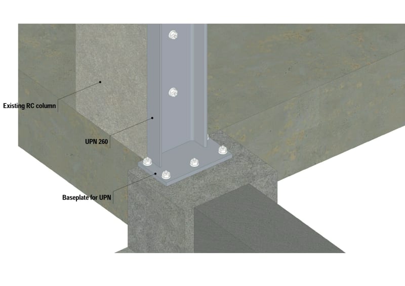

Hi everyone,
1) I want to design a 2-storey steel frame extension on an existing concrete frame.
2) The two beams that run parallel to the concrete beams will need to be anchored to the beams (to connect the two structures)
3) The floor will be a composite metal deck.
4) The composite floor will need to be anchored to the existing RC frame with starter bars connected to the composite floor reinforcement bars.
5) Seismic loads need to be considered in the design
My question is. Since the two structures need to be connected to each other (due to seismic loading) and have a composite behavior what is the best way to connect the steel column shown below, to the existing RC Column?
