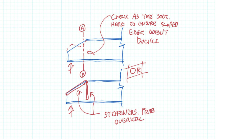

I have a steel beam that I need to tuck into an attic space. The issue is the beam ends are too tall to sit on top of the wall plate and not penetrate the roof decking. (W12 beam with 6" of open space for the beam to sit.)
Is there a code requirement for chamfering (dog earing) a steel beam at the support so long as there is sufficient material to carry the shear loading at the support?
Any assistance is greatly appreciated.
