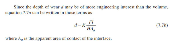

There are some models that cover fretting fatigue and abrasive or adhesive wear. I'd have a look through some of the classics. I have done these type of calculations to inform inspection requirements/schedules for pin/bushing interfaces before.

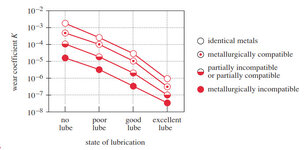

A good reference is Robert Norton's "Machine Design: An Integrated Approach", specifically chapter 7. Based on the materials, applied force, contact area (maybe the trickiest to compute, you might need a Hertzian contact analysis), etc. you can predict the depth of wear. This can inform a basic understanding of how many load applications are tolerable but it's a bit iterative because the contact area will change as material is worn away.
@LD ... something about that graph (of K) seems odd unless the other factors mitigate ... ok, so K decreases with Lub ... makes sense ...
but why is wear for incompatible metals 100 times less that identical materials (at the same lub assumption) ?
is the legend flipped ?
RB, the source of this graph is originally from Rabinowicz who "wrote the book" on wear, so to speak. The source of the figure from Norton is actually from the Wear Control Handbook by MB Peterson and Wo Winer. I have done some checking to make sure it is correct.
I think the thing to keep in mind is that this figure is specifically for adhesive wear from contact of parts. The wear coefficient here is associated with material loss. If the materials are metallurgically identical, deposition of material through adhesive wear in sliding contact, for example, will be "easier".
Your intuition I think is correct though because we generally tend to think of dissimilar materials as having different hardness which also has a big effect on wear. There is a separate parameter for hardness in the wear depth formula, the effects of which might have a bigger impact than the constant, K, I guess, depending on the materials.

You offered a formula to calculate wear of the race the balls are running on.
Not inherently, no. This is a general method for characterizing wear depth that is not specific to bearings or bearing races.
