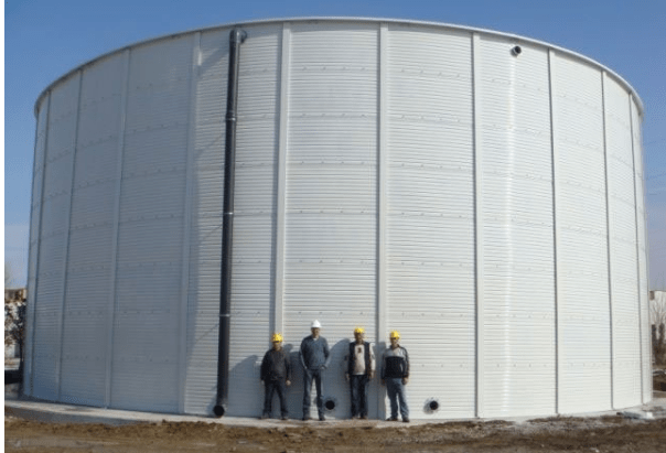

Somehting like this?
Looks about 8m tall at least. And you want to guess about the foundations?
