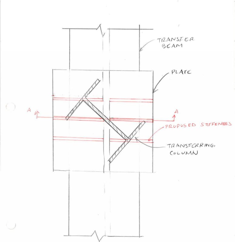

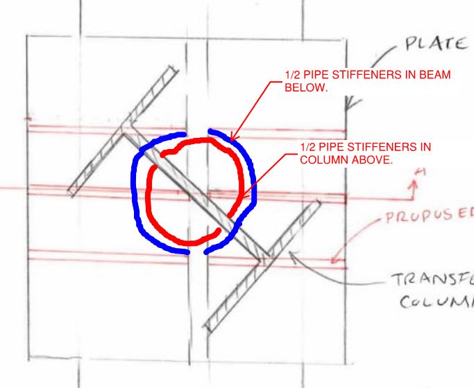

Good Morning,
I'm designing a steel transfer structure, where a number of the transferring columns are skewed relative to the supporting transfer beam. Thinking about this, I would like to include a stiff plate below the transferring column, and then include stiffeners extending the full width of the plate. I've attached a sketch of what I am thinking to do here. If anyone have any thoughts about this approach or any input / resources that might relate to this condition, it would be greatly appreciated.
Thanks so much!

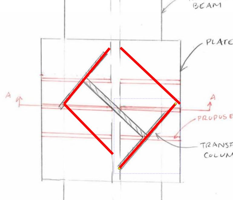

I feel that a worthwhile goal here is to get as much steel column area over top of stiffeners as possible. It doesn't have to be the entire column area, or even close to that, but As x Fy should work over that area without any local buckling issues.
See the the sketch below for one idea for a stiffener arrangement. Not super fun to fabricate but it mechanically sound. If you could run some short plates across the flanges of the column near the base to make that a box section too, all the better. Note that some folks consider a closed off space to be a fireproofing issue. I'm not convinced of that myself but it's something to consider.

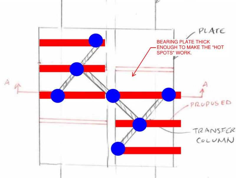

Or maybe stiffeners on top...
What is your axial load as a percentage of the column [phi x As x Fy] here? That would be helpful as an index of the scale of your problem.

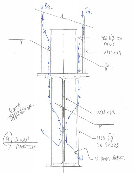

Another option here, similar to what KootK first proposed, is to use half (or maybe 1/3) of a round HSS section on each side of the web, instead of the pairs of plates. We have used those for the bearing stiffeners on a few bridge superstructures.
I second the top web stiffeners in the column aligned with the web of the transfer girder, but another option would be to cut a WT from the same shape as the column section. Make the WT fitted to the flanges of the transfer girder, and fillet weld all around the accessible areas.
Oh... my... gawd! This isn't quite rod's solution but, thanks to his inspiration, I'm pretty sure that this is the sexiest of all possible solutions. Mechanically perfect and pretty easy to fab. We should all get the afternoon off now.

Thank-you all so much for your ideas! I really appreciate it. I'm going to have to give the HSS solution some thought to figure out how the force would actually get to the web below along this curve.
dhengr, to answer your questions, columns are all skewed 45deg to the transfer beams. Typical columns are W10x49 and a typical transfer beam is W21x62. Factored loads are around 350kip.

This would be the load path for my last scheme. I drew it at 90 instead of 45 on account of this not being art class. W10x49 is nothing; hardly bigger than my massive forearms.
For those size members, I think the proposed bearing plate and stiffeners in the original sketch should work just fine. KISS.
It would seem to me that if you employ the 6" HSS around the column, you could dispense with the bearing plate, or alternately, include the bearing plate and not the 6" HSS.
For bridge girder bearing stiffeners we do pretty much the same thing, only upside down. We don't really concern ourselves with the internal shear flow through the stiffener. We just check the slenderness (moment of inertia) for buckling. With the half-circle welded to the web on both edges, the resistance to buckling is extremely high; much higher than a plate. At less than 21" in length, if you checked the HSS section for buckling as a plate (which would be massively conservative), the required wall thickness would still be fairly small.

1. On the original sketch with the three stiffeners, make sure that you have weld access to get in the welds on the center stiffener and the inside of the outer stiffeners. A good way to check is to project a line at 45degree out to the edge of the stiffener. Anything that is within that bound will make it a difficult job to weld (thus more $$$).
2. The HSS corners will need to be clipped because of the k distance on the beam. This was shown on the original sketch of the stiffeners, so I think it's still observed as a necessary detail. It just means a little more fab coordination, but is not the end of the world.
I like the stiffener idea (KISS) and think you can make it work. I would keep the base plate on the column rather.
Is there anything stopping us from welding only one side of a stiffener? Even we welded the top of the stiffener on two sides but the side of the stiffener on only one, I'd think that the stiffeners could be installed sequentially without weld access issues.

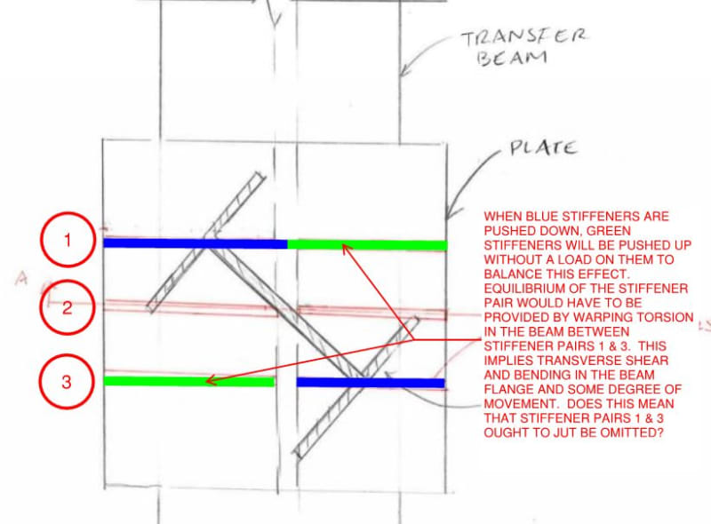

Something about the originally proposed stiffener arrangement has caught my eye. Forget, for now, that the loads here are likely so small that anything will work. Imagine big, scary loads.
Hmm...Only if the loads were high enough that they cause local yielding of the column web when the loads are focused through the point where it aligns with the web of the beam. Until that happens, I think the concentric load transfer is dominant. Once the torsional stiffness of the beam is greater than the stiffness of the web due to plastic flow at the point of contact, the beam will be engaged in torsion (albeit over a pretty short length).

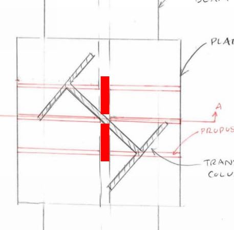

I would remove them, but not necesarrily for the torsion reason. With a W10 column, the spacing between those plates can't be more than 2". I've never met a welder with hands that small.

Right, but if you never get to that point, then there's really no sense in having any of the stiffeners. I believe that the idea is to create multiple points of contact that are each stiff enough that one can assume that they're sharing the load. The question with this is whether or not that's true when the load on a stiffener pair is unbalanced and beam torsional resistance is forced to come into play, albeit over a short distance.
I agree with you, but I don't think it's going to be significant at first. The load is going to be shared between each part of the connection in proportion to various stiffnesses of the elements, right? Well, which is stiffer - the concentric axial force transfer from column flange to beam flange through the area where they overlap, or the twisting of the beam's cross section? Seems to me the axial load path is stiffer. So, yes, the beam will be resisting some load through torsion, I don't think it'll dominate as long as the axial path remains viable. After all, most of the efforts of the methods employed above are centered around keeping the load centered, right?
