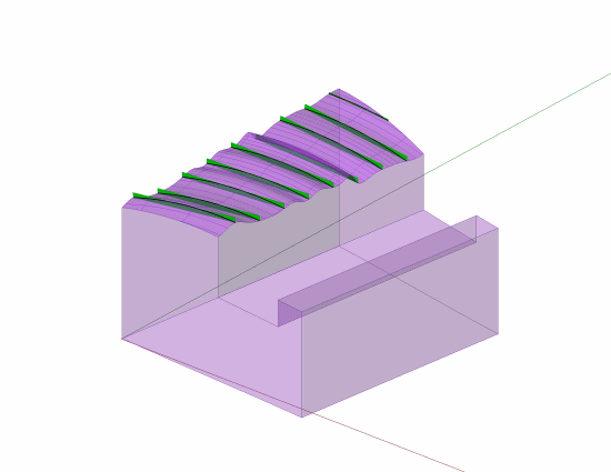

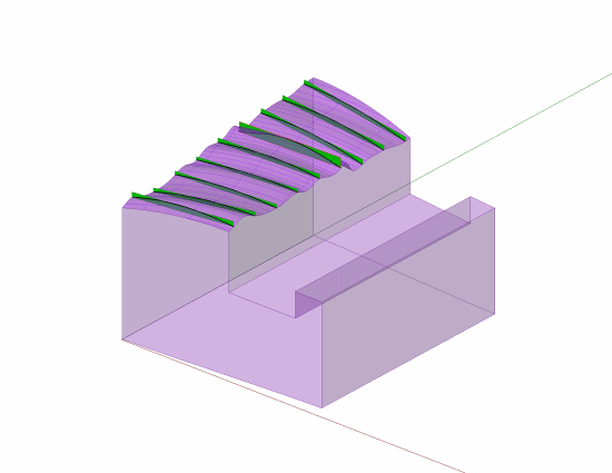

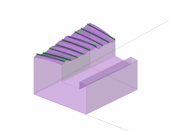

dtmbiz,
Thank you for the comments on my figures. It's interesting how you saw them as being based on how the part would be measured - that wasn't quite my intent.
I think that the figures (especially the final one) show the result of applying the straightness tolerance to actual part geometry, but are not specific to a particular inspection method. This result could be accomplished using a number of different inspection techniques - open setup with dial indicator and surface plate, CMM, straightedge, or physical sectioning. Whatever technique is used must maintain the required constraints and degrees of freedom between the line elements (established using parallel cross sections) and the tolerance zones (also established using parallel cross sections but free to rotate and translate). For example, the non-parallel-ness of the tolerance zones allows the inspector to level the part individually for each indicator sweep if the open setup method is used.
Your interpretation that the zones must be parallel to the perfect line element, and therefore parallel to each other, is not one that I have heard before. I re-read your original post, and the text of section 5.4.1.4, and I believe that I now understand the basis of your interpretation. You are taking the phrase "to control line elements in a single direction" to mean that the tolerance zones must all be oriented in a common direction, and therefore the zones must be parallel to each other? Do I have this correct?
Here are more figures to illustrate the comparison. One interpretation is on the left, with zones that are individually fitted to each line element with no constraints (other than staying in the cutting plane). The other interpretation is on the right, with zones that are individually fitted but with the constraint that the zones remain parallel to each other. So the overall twist of the surface would not affect the straightness with one interpretation, but affects it with the other. Does this capture the issue?

dtmbiz,
It sounds like we're on the same page (or at least on one of the same pages). We still don't agree on whether the straightness zones need to be parallel to each other or not, but I think we agree on the consequences of either case.
If the zones are required to be parallel to each other, and there are two straightness controls, then I think I agree that this combination would limit the maximum flatness error. But I'm not sure what the maximum limit would be - I'm not sure that it would be a straightforward combination of the two straightness values. I would also say that this combination would not require one set of zones to fall within the crossing set - it would just mean that the surface needs to conform to both sets of zones. This is a subtle distinction though.
Personally, I don't place much value in the "maximum possible flatness arror from other controls" discussions. If the designer needs the flatness to be controlled, they should be able to specify a flatness control and not rely on indirect controls. But Y14.5 makes us care about things like that, by disallowing geometric tolerances that are not a refinement of other tolerances that would limit the same characteristic.
The tolerance zone orientation, in terms of being view dependent, is a separate issue. I wish that Y14.5 would explain this better. The thing that is view dependent is the orientation of the cutting planes, and this is what Mark is referring to with the "weak" definition. It's weak because we can't establish the "view dependent" direction for the cutting planes uniquely on a real part. I tried aligning the cutting planes three different ways - perpendicular to the left-hand face of the part, parallel to the front face, and best-fitted to the considered surface. Here is what the results look like:
The measured value of straightness, which would be the width of the largest of the fitted zones, is different for each case. This is because the faces of the part are not square to each other, and the "lay" of the surface is not square to the faces. Because the current definition does not specify how the view direction is established on the as-produced part, any of these three possible cutting plane orientations is allowed (as well as many others). As Mark mentioned, the ISO GPS standards have additional symbology to align the cutting planes to specific features on the part. Before you say it, CH, in most applications there would not be an appreciable difference but in certain applications there might).

John-Paul,
I'm assuming that you mean parallel to each other in the sense that the cutting planes are parallel to each other. Not in the sense that dtmbiz is contending. But I'm not sure ;^).
This is why the words fail us - the zones can be parallel to each other in one sense, and not parallel to each other in the other sense.

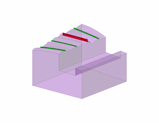

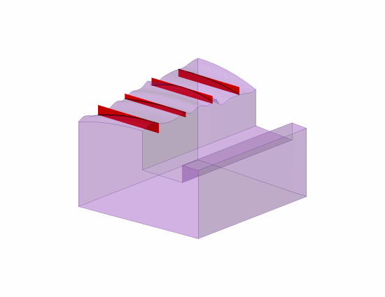

In my post from 17:08 Sep 23, there are two figures. The left-hand figure has three green zones and one red zone, and the zones are parallel to each other in one sense and not the other. The right-hand figure has four red zones that are parallel to each other in both senses. Which figure do you think is correct?

Evan,
Yeah, maybe I wasn't following the wording too closely, but here's what I meant: The planes that we slice up to check the straightnesses must all be parallel to one another. The zones within each slice can rock/rotate all they want, as long as they stay within those cutting planes.
So of the two pictures you posted at 17:08, I think I'm agreeing with the first one (with the green zones).
My beef remains this: to what surface on the part should those cutting planes be oriented? I wasn't following the other comments in this thread much because this simple ambiguity is enough for me to blow off the entire idea of straightness applied to a flat surface.

John-Paul,
That's what I thought you meant. Your description of the zones agrees with my understanding.
Your remaining beef relates to the other issue that CH just mentioned, of how to orient the cutting planes to the part. I believe we're all in agreement that there is no unique way to establish the "view direction" on a real part, giving us the ambiguity. In other words, the degrees of freedom between the part and the cutting planes are not constrained. Where there is no constraint, we are allowed to optimize.
