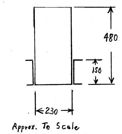

The beam is 480mm deep x 230 wide, spanning 6m and has 3 N16 twisted bars bottom(scanned) and we assumed 3N12s top. The beam does seem to be under reinforced and has 5-10mm flexural cracks every 200mm. There are signs of concrete cancer in areas around the beam and evidence of what appears to be repairs to corroded reo.

This was my initial plan and would be ideal, however, I'm limited to a depth of 150mm for my channels and I'll need to consider the strength of the existing beam to get the capacity out.

I have not done any calcs, but sometimes a simple, reasonably accurate sketch can say a lot:
IMHO you can take the added 150mm steel channel option off the table and look into other proposals being discussed.
1) The reduce deflection, moment of inertia has to be increased.
2) Consider the pair of 150 mm channels to be "perfectly" attached to the concrete beam.
3) Do the calcs (similar to flitch plate math) to determine the moment of inertia of the composite.
4) I think you will find that even with "perfect" attachment, 150 mm channels are not adequate to significantly reduce deflection.
