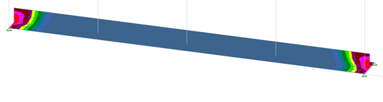

I am working on a problem where I have a roughly "T" shape profile (inverted) where I am applying two equal point loads to the top of the single leg. I am trying to evaluate stresses on the flat plate caused by the cantilever leg. I usually simplify this problem and simply assume a flat plate with a moment applied at midspan. However, I'd like to make a more "real" analysis without going into FEM. I've looked through Roark and other sources but to no avail. I am definitely missing something... do you have any help or insights to spare? (is it even worth the effort?) Thanks! T Profile.jpg

What sort of force magnitudes are we talking here? Depending on the load there might be some simplifications that you can make without losing too much sleep on it. Otherwise FEA is the way to go.
Here's a quick model with F1=F2=1kN just to illustrate what kind of stress distribtion you'd expect; this is in line with what KootK has shown above.
What I'm seeing is that the web of the T is getting a stress concentration on the end which could suggest some form of buckling, long before the load fails towards the middle of the plate.

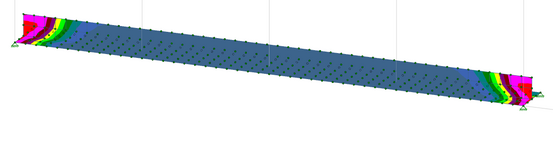

Thanks for that, I realized I over-simplified the analysis a bit (one of the edges of the bottom plate is continuously braced, the other end is free). I add an improved sketch.
Deflection is not a concern. The design objective is to avoid local yielding at the point where the leg meets the plate.
Roughly 1-1.3 kips. Loads are relatively low, but the shape is pretty slender too. This one is thicker than usual at 1/4". Other T shapes I've worked with are 1/8".

Adding the supports to the braced backside helps unload the flanges a bit but you still get that same stress concentration on the web "T". Take it with a grain of salt, but with your loads in and modeled as 1/4" thick the maximum stress in my FEA is exceeding your typical 44W steel.

Performed a quick FEA and yes, same results. Using the usual approach with the moment at center of beam gives me a much higher stress at the plate.
