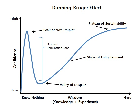

The most important thing is to know ones own abilities. And educated yourself widely such that the 'unknown, unknowns' don't come and bite you because they are the problems.
Or to put it another way. Make sure your learn enough that you feel like you don't know enough! Don't climb the first hill of dunning-kruger and think you know what you are doing!
