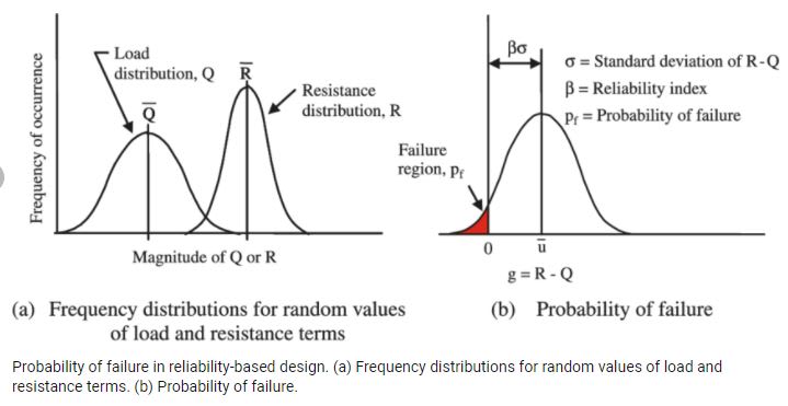

I have a solution that I've been espousing here for years. I promised myself that I'd stay out of this thread because these ones always just leave me feeling sangry. But, alas, I can take no more.
STEP #1: Recognize the true nature of the problem. Because of the graphs shown below, it is the deliberate nature of our work that very few problems actually arise regardless of the quality of the engineering. Effectively, poor structural engineering has no meaningful consequences for our clients (sounds odd, I know). That is a goddam huge problem because it means that the people who hire us cannot discern the work of a good structural engineer from the work of a bad structural engineer. This leads to us all racing to the bottom technically and, instead of competing on the basis of our core competency, competing on the basis of stuff that anybody with a decent head on their shoulders can do such as responsiveness, buildable designs, pretty drawings, project management, and oral pleasuring from the sales guys at Xmas.
STEP #2: Structure things such that good structural engineering has meaningful consequences for our clients. Since we can't dial our safety factors down to unity, I propose that all structural engineering work should receive a truly meaningful peer review from someone truly qualified to conduct such a review (me, Fazlur, or Leslie probably). I propose that this review be anonymous, be capable of putting an indefinite hold on permitting, and be associated with a fee designated of X% of the building cost no matter what the EOR charges. It is conspicuous that many of the jurisdictions that currently pay structural engineers well are high seismic jurisdictions with some combination of a) meaningful peer review and b) obvious consequences of crap design in the public's recent memory.

a. As KootK explained very well with that graph, problems (real ones, not some extra cracking or extra deflection) are very rare and so there is no clear border or performance criteria evaluation and because of this some part of our community decide that the risk of doing a bad job (going under code limits and underdesign it)is financially worth it. So they win projects by low construction price/m2 (our final clients are only interested in costs) and also create a pressure for the other firms to make compromises so that they survive in this market. This creates a big pressure for final steel and concrete quantities - if we want to take a project beside the architectural demands are also quantities ones that most of the time put us in the situation of making compromises.
