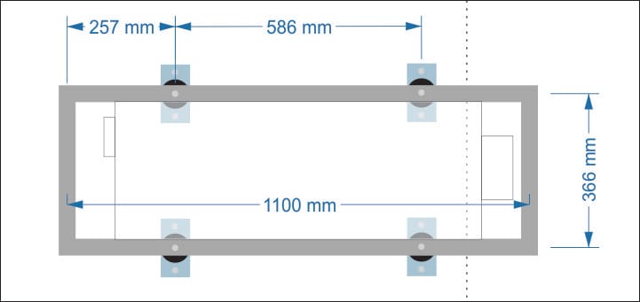

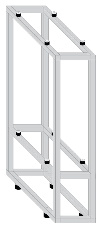

I've recently bought two mini split heat pumps and want to build a stand to hold the outdoor units. I would like to obtain an E-shaped cantilever structure but am unable to determine whether the beams will hold the units safely in place without adding some form of additional support (e.g. diagonal braces).
I plan to use 50mm x 50mm x 2mm (2" x 2" x 14ga) square steel tubes which are going to be welded together as shown in the drawing above. The small cylindrical shapes are rubber-metal mounts that will go underneath the condenser units to prevent vibrations from being transferred to the steel frame. I might also use some larger rubber-metal buffers to decouple the stand from the concrete foundation on which it will be mounted, so any unmitigated vibrations don't find their way into the nearby walls of the house.
The weight of the outdoor units is 43kg (95lb) each, and the way this weight is distributed on each corner is shown on page 11 of LG's product data book (i.e. page 13 of the PDF) linked below.
Since this stand is only going to be secured to the ground (and not to a wall), my main concern is stability, i.e., supporting the weight and stress from the two condensers without bending, breaking, or tipping over, while enduring the fluctuating weather conditions.

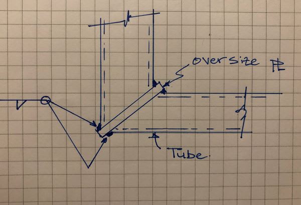

The bottom frame members are mitred together at each corner in a 2-way mitre. The post is square cut to sit on top. On the picture below, the post is to the left and we are seeing the underside of the base to the right.

This is my preferred method for providing the corner of a tube frame if you can tolerate the extra plate sticking out - especially for thin tube (or for backyard welders).

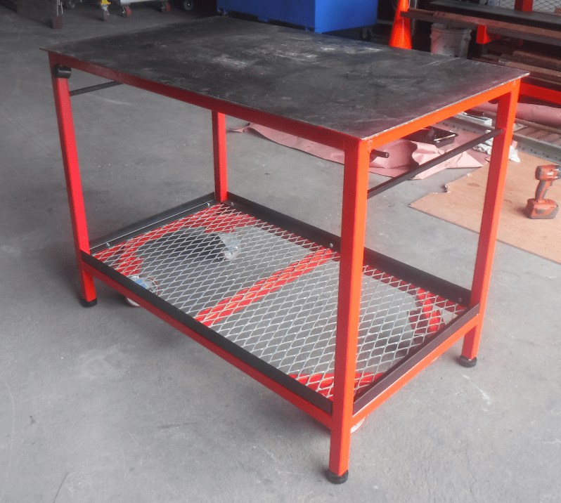

DIY of HSS is not too difficult, especially if your tube wall thickness is > 1/8" - provided you have the right equipment. I am a self-taught welder and built this mobile welding table in a few hours - 1.5" x 3/16" wall, square tube - very strong - supported many thousands of pounds of steel fab on this unit. Took me longer to paint it than to cut and weld it up. I hate painting!

I had a recently retired architect friend of my parents look at my sketches and he said that if I use the 2"x 2" HSS, I won't need any supporting braces/struts and could probably do without the front corner posts in the bottom as well, because the load is very light. For the vibrations, he suggested I cut a rectangular hole in the concrete with a circular saw, dig out some soil and pour a new concrete slab that won't be touching the surrounding one. Anchor the verticals in the new concrete and drop the bottom frame, similarly to what BAretired suggested. But as I already said, I would rather not mess with the concrete as I would probably need to hire someone else to do it and wait for it to dry for weeks before I can mount the whole thing. And it's too close to the walls of the house, which might open a new can of worms.
I can get a local welder to execute the build, but I want to at least finalize the design (including the basic details of the welding process) myself.

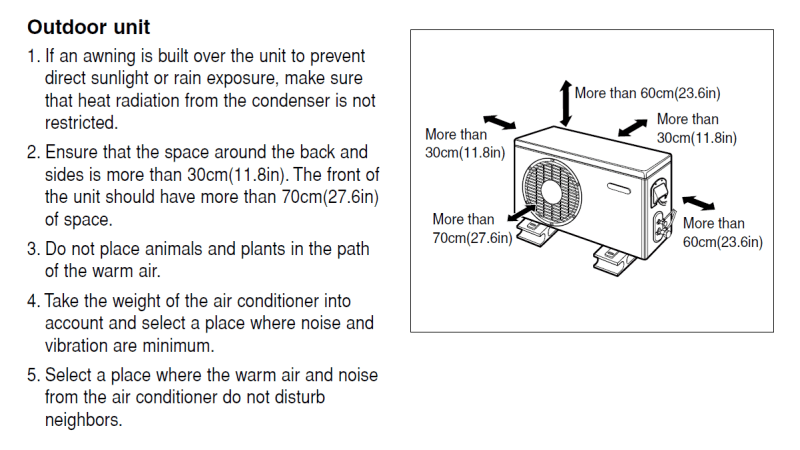

Because I don't have sufficient space to put them side by side in the location I want to utilize. Clearance requirements suggest a lot of open space around them — they will have to be placed at least 1 meter apart and be clear of any surrounding obstacles.
Page 47 of the manual you linked says otherwise. If the units are outdoors and have only ground and one wall and no overhangs, the clearance requirement is more like 250 mm, minimum. This suggests that your upper unit does not need to be so high; eliminating 400 mm from the height would drastically reduce the tipping and bending concerns.

Tipping, yes. Bending, not really. The problem with the outriggers supporting the units remains the same. They would still need more support than the two posts at the back.
BA
Good catch, but the normal/preferred clearance is actually 600mm, which is the minimum I would aim for.
Page 10 of another, more generic LG manual (
My '1 meter' claim was erroneous — I was adding up 30cm and 60cm and giving it an extra 10cm 'just to be safe' which was obviously a mistake.
No, the 250mm-600mm figures are for the sides only. The top clearance should be greater than 600mm as shown in the picture above, or 1000mm if there are surrounding walls like in Case 1 in the other manual. (That is, unless I'm missing something.)
If I use the rubber mounting feet and raise the frame a couple of centimeters off the ground, I might be able to go with a simpler design, something like this:
In this scenario, the rubber feet will have to be positioned further away from the corners (either close to or exactly where the condenser mounting points would be) because the solid concrete ends at the dotted line and I can't place the stand any further to the left:
But I have no idea how clever it is to use the rubber feet (regardless of which design I go with), both because of rubber degradation concerns (lifetime/need of replacement down the road) and reduced stability (as opposed to securing the stand directly to the concrete).
