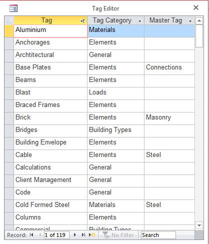

In my scheme, the tag system runs off of a conventional relational database structure. Two things that I like about that are:
1) No issues with misspelling tags. "Post-Tensioned Concrete" is always "Post-Tensioned Concrete" and is never confused with "Post Tensioned Concrete" or "PT Concrete" etc.
2) I've leveled off at 119 separate tags. Using a relational system, I'm able to group those into categories that each contain 8-10 tags. That way, I can get to the tags quickly. If you look closely at the bottom right of the screen capture, you'll get the idea. A view of the underlying structure is shown below.
3) The database allows each tag to potentially have a "parent tag". If you tag something "precast" it will automatically get the concrete tag as well. If you tag something "shear wall" it will automatically get tagged as "lateral" etc.

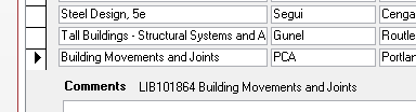

2.0 File naming and how the system finds your PDF files
The system will automatically rename all of your files according to the following nomenclature: [LIB] + [SPACE} + [Six Digit Number] + [User specified document title]. You can't have colons in the file name. This trips me up from time to time. Replace all colons with dashes. The system does not contain your files. Neither does it even contain links to your files.
The system knows your files simply by the six digit library tag (snippet above). When you click the "link" button to have a file displayed, the system hunts through your root folder and all of its sub folders until it finds that six digit tag. Then the system opens the associated file. While a bit odd, this setup has one huge advantage. You can reorganize your files within the root folder without ever worrying that the system will lose track of them. The system never had them tracked in the first place.

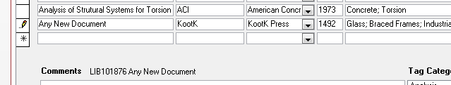

4.0 Adding your first file
The system comes with one document record already loaded (AISC 13th). The reason for this is that the system has some issues when it's entirely empty. Once you have other records entered into the system, you can delete this one. Note that the record is not associated with a PDF. That's because I use the system to log both PDF documents and hard copy documents. For me, the AISC manual is a hard copy document.
4.1 You can fetch a PDF document from anywhere but, to get the most of out of the example, start with a new PDF on your desktop.
4.2 Ideally, the file name would be less than ideal so that the system can modify it for your.
4.3 Start a new record and click the "Link" button at the end of it. A file chose dialog box will open.
4.4 Navigate to and select your file. If your file is not located within the root folder sub directory system, the system will ask you if you'd like to move it there. Say yes.
4.5 A folder chose dialog will open and allow you to navigate to the folder within the root directory where you would like to store the document.
4.6 The system will now have moved your document and renamed it [LIBXXXXXX ORIGINAL FILE NAME]. I has also guessed that you may want the title of the document to be whatever the file name was. That's usually a good place to start and sometimes saves some editing effort.
4.7 Adjust the name of the document within the system. Don't use any colons and remove ".PDF" from the name. Once you've edited the title, the system will automatically rename the file to reflect that.
4.8 Fill out the rest of the fields as you see fit and save the record. You can save the record by either moving to another record, moving to a control outside the list or, most conventionally, by clicking on the little pencil thing at the left hand side of the record.

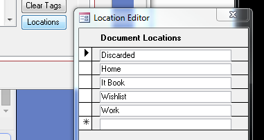

7.0 The "Location" field
I use this field to indicate where the document is. It's mostly intended for physical documents. If it's a PDF, I chose WORK. If it's at home, HOME. If it's real book stored at work, WORK. If I loaned it to my colleague Kevin, then I type KEVIN. The choose box runs off a predefined list that you can edit as shown below. You're not limited to the list though so you can enter one off's like "KEVIN" without a bunch of overhead.

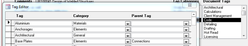

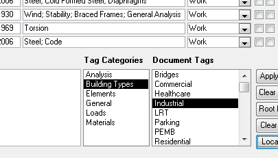

8.0 The "Tags" field
This is the good stuff. And the important stuff. We'll talk about how you set up your tag options later. For now, we'll just look at how you add them to a record.
8.1 Go to the "Tag Categories" list box and select the category that contains the tag that your interested in. "Materials" maybe. Select material and the "Tags" list will repopulate accordingly.
8.2 Find the tag that you want in the "Tags" list and double click it. It will be added to your record. As as many tags as you care to this way. Double clicking a tag that already has been added will cause that same tag to be deleted.

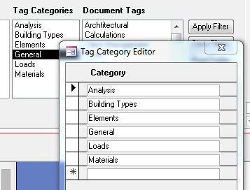

9.0 Setting up your custom tagging system
The system comes pre-loaded with my tagging system. If your serious about this, you'll want to ditch it and spend some time coming up with your own system that work how you need it to.
9.1 Right click over the "Tag Categories" list box and, in the context menu that appears, select "Edit List Items". In the editor that pops up, set up your tag categories as you like. Note that you cannot delete a category that contains tags. You can only edit it. To delete a populated category, you need to delete or move the tags that it contains.
9.2 Right click over the "Tags" list box and, in the context menu that appears, select "Edit List Items". In the editor that pops up, set up your tags as you like. Each tag must be assigned to a pre-existing category. Optionally, each tag can have a "Parent Tag". That's best explained through example. I have a tag that is "base plates". It's parent tag is "connections". If I tag a document with "base plates", I'll get "connections" too automatically. No biggie, just a minor time saver.
