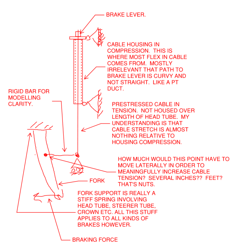

At the beginning of covid I acquired a version of the bicycle shown below. It's a 1992 Miyata 1000LT. It was the best, production touring bike that one could buy in 1992 for any amount of money. It is legendary for being a sweet, smooth, "steel is real" ride and the legend could not be truer. When I ride the bike, I feel so little discomfort in my body that it's almost as though someone chopped off my head and mounted it to the handle bars. I feel nothing but joy and exertion.
Performance wise, the only non-awesome thing about the bike is the cantilever brakes. As cantilever brakes are prone to doing, hard front braking will induce a pulsating front end shudder that is very disconcerting. Before attempting to fix the problem, I would like to accurately diagnose it. Everywhere this question is asked out in the online Bike-o-Verse, you get the same "bow and arrow" explanation described in detail here: Link. Looking at that explanation as a structural engineer, I find it to be utterly implausible. Some suggested remedies can also be found at that link but I deem them to be questionable because, in my opinion, they are based on a flawed theory of causation.
So my first question here is this: what do you think of the "bow and arrow" explanation? Do you buy it? Do you share my skepticism? I have reasons for my doubt, of course, but I'm going to withhold them for a spell here in the hope of not contaminating the thought pool. I've reproduced part of the "bow and arrow" explanation below for reference.
I've got my own theory about the cause of the fork shudder which we'll get into in more detail on later. The short version is that I think that it's a function of torsional fork twist rather than the front to back fork flexing that the "bow and arrow" theory suggests.

Coming back to the truthiness of the "bow" hypothesis, this is the structural model that I see. I feel that it makes it rather obvious that fork flex could not be the cause.

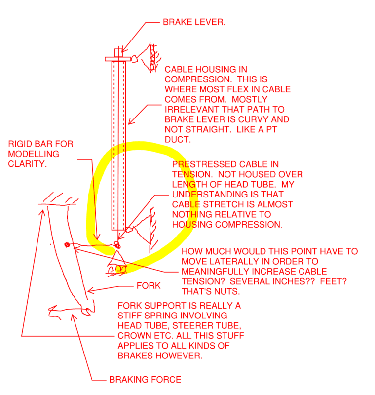

Similar to this link, the commonly proposed solution is to add one of these cable hanger things that brings your housing closer to the brake. As I see it, that only modifies my previous model as shown below. As such I don't see how it would accomplish anything meaningful. It might actually make things worse by adding extra housing length and softening the transmission of braking force from the lever to the pads. Me no understando.
If there is a stick-slip the fork will tend to amplify the effect. As the pads stick the force shoots up, bending the fork/steering tube in addition to the deflection of the pad. When the pad then slips, the force drops off and the fork/steering tube snaps back. Depending on the mass of the rider and the spring rate of the fork/steering tube it might set the natural frequency into an uncomfortable/noticeable range. To be clear this is the deformation from the force the axle applies to the fork tips, not what the brake mounts apply to the fork.
