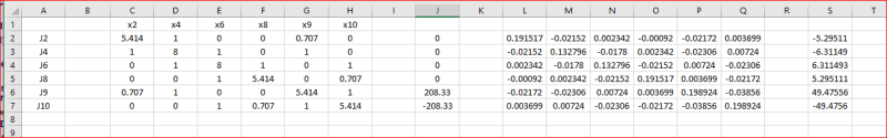

Sorry to hear that. I found x2, x4 and x9 to be as follows, but I used relative EI/L, not the actual values:
x2 -5.294935592
x4 -6.311284333
x9 49.47392592
For the typical member, I considered K = 2EI/L to be 1.0, but for member 8, K would be 0.70711
On that basis, I find the following moments:
M2-1 = 0 - 2*x2 = 10.6kN=m
M2-4 = 0 - 2*x2 - x4 = 16.9
M2-9 = 0 - 0.7071(-2*x2 - x9) = -27.4kN-m ------- Sum = 0 (check)
M4-2 = 0 - (2*x4 +x2) = 17.9
M4-3 = 0 - 2*x4 = 12.6
M4-6 = 0 - (2*x4 +x6) = -x4 = 6.3
M4-9 = 0 - (2*x4 +x9) = -36.85 ------- Sum = 0 (check)
M9-2 = 0 - 0.70711(2*x9 + x2) = -66.22
M9-4 = 0 - (2*x9 + x4) = -92.64
M9-10 = 208.33 - (2*x9 + x10) = 208.33 - x9 = 158.85kN-m ------- Sum = 0 (check)
The sum of moments at Joints 2, 4 and 9 is zero as expected.

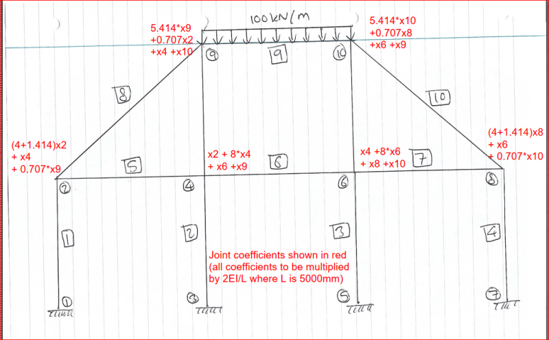

It appears to me that you have some errors in your joint equations. The sketch below shows the joint coefficients you should be using. They include the length difference for the diagonal members.

Update: Found the inverse, but the answers can't be right because x2, x4 and x9 do not equal -x8, -x6 and -x10 respectively, which they must because of symmetry. Looks like we'll both have to sleep on it.
Update #2: Found the error. Made a mistake in typing one of the cells. The answers agree with the results I found using only three nodes.
Rotations x2 through x10 are shown in column S of the table above. To get the correct rotation, multiply all values by 2EI/L.
BA
BAretrired, that is amazing what you have done. However, could your point out what error I made in my joint equations? This will be good for learning.
I believe I was mistaken about an error in your joint equations. So far as I can see, they are all okay. I am attaching the results of both sets of calculations (see below). In both sets of results, the original joint matrix is from columns C to H. Fixed end moments are in column J. The inverse matrices are from columns L to Q and the final values of rotations are in column S.
In both cases, x2 = -x8; x4 = -x6 and x9 = -x10.
The sum of Joint moments is zero for both results below. If you are getting different results from those that I show, the problem may lie in a misunderstanding or misapplication of your software.
BA results on Rows 2 to 7:
Tygra results on Rows 9 to 14:
Conclusion: there is nothing wrong with the equations in either set above. In both cases, the sum of moments at every joint is zero.

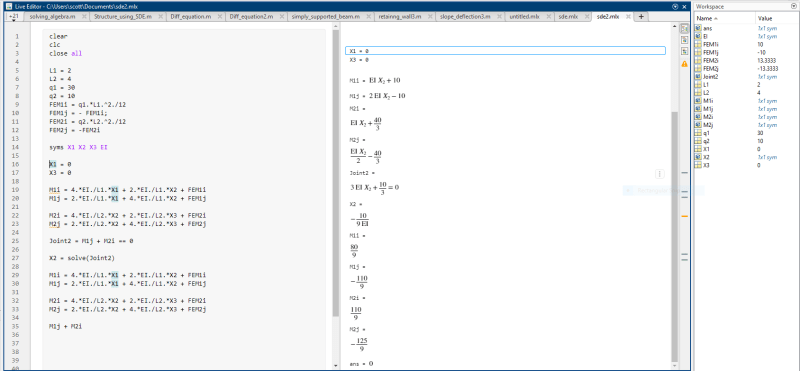

I think it is a misunderstanding or a misapplication of my software (Matlab). However, I am not sure what route to go down though. I was thinking of making a matrix for X2,X4,X6,X8,X9,X10 values, but that is quite tedious. What do you think NicOkai?
Edit: just caught your edited post BAretired. Hoping you can save me from this torment tomorrow lol.
Edit2: I think we need someone that is exceptional in Matlab too.

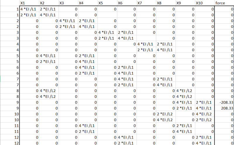

FEM = [stiffness][rotation]
rotation = FEM\stiffness. I have attached the excel, sheet2 is the numerical expression. Try that and see if it works (kindly verify my units of E and I in the spreadsheet. Is this due tomorrow or it's a personal project? (I have an ideal but that we don't have time for that now, it involves writing a whole different script)
EDIT
If you break it down to Joint 2, Joint 4, Joint 6, Joint 8, Joint 9, and Joint 10 you should get the same matrix as BAretired.

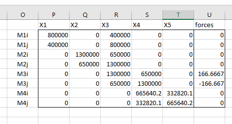

Here is the structure with its answers.
[URL unfurl="true"]https://res.cloudinary.com/engineering-com/image/upload/v1634570812/tips/Stiffness_method_wilfbz.pdf[/url]
This is my Excel matrix
This is the Matlab code with the rotations I am getting using.

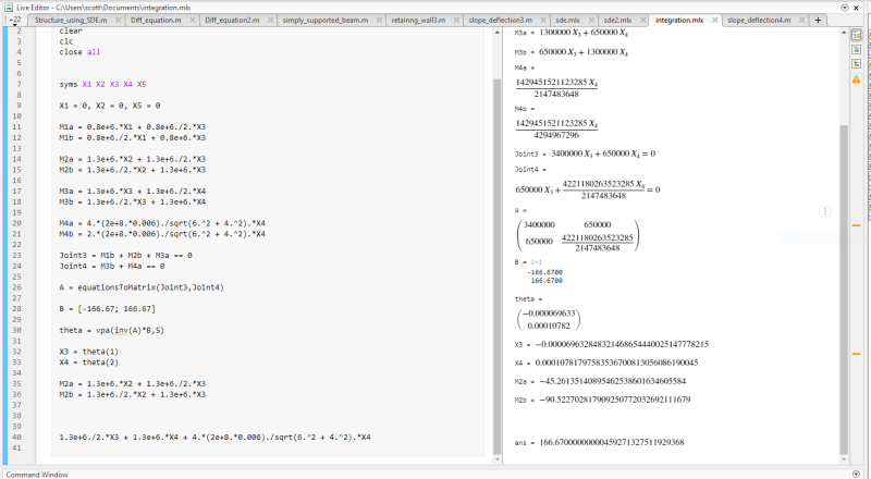

Still getting Incorrect results guys.
m1i = 0.8e+6, m1j = m1i./2
m2i = 1.3e+6, m2j = m2i./2
m4i = (2e+8.*0.006)./sqrt(4.^2+6.^2), m4j = m4i./2
FEM1 = 166.667
FEM2 = -166.667
syms X1 X2 X3 X4 X5
X1 = 0; X2 = 0; X5 = 0
M1i = m1i.*X1 + m1j.*X3
M1j = m1j.*X1 + m1i.*X3
M2i = m2i.*X2 + m2j.*X3
M2j = m2j.*X2 + m2i.*X3
M3i = vpa(m2i.*X3 + m2j.*X4 + FEM1,5)
M3j = vpa(m2j.*X3 + m2i.*X4 + FEM2,5)
M4i = vpa(m4i.*X4 + m4j.*X5,5)
M4j = vpa(m4j.*X4 + m4i.*X5,5)
joint3 = vpa(M1j + M2j + M3i,5)
Joint4 = vpa(M3j + M4i,5)
y1 = equationsToMatrix(joint3)
y2 = equationsToMatrix(Joint4)
A = [y1; y2]
B = [FEM1; FEM2]
Theta = inv(A)*B
X3 = Theta(1) = 0.000077298482151272739116422631226081
X4 = Theta(2) = 0.00014791975279127278677572495087085
3.4e+6.*X3 + 650000.*X4 + 166.67 = 333.33700000000000159161572810262

Hi BAretired,
Yes, I have solved both problems now, although the smaller problem does have me scratching my head a bit. This is because I have attained the answers that in the handout (the yellow sheet I previously attached), but strangely my joint equations doesn't equal zero. See the image below:
For the larger problem my joint equations don't equal zero exactly, but they are a very small number close to zero - like 7.3e-39. Do you think this could well be the correct answers? The rotations match the symmetrical geometry of the structure too.
Sounds good to me! 7.9e-39 is about as close to zero as you will get with a computer. Congratulations!
BA
Thanks, BAretired. We got there in the end! I have found a great function in Matlab called 'equationsToMatrix' that converts the linear equations into matrix form. Solving the matric gave me the correct answers!
What do you think about the smaller problem? I am getting the correct rotations of X3 = -6.96e+5 and X4 = 1.08e+4, but my joint equation equals 166.67?
