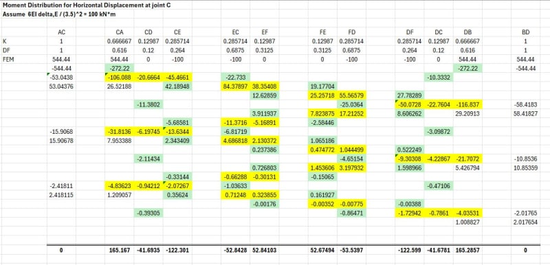

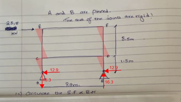

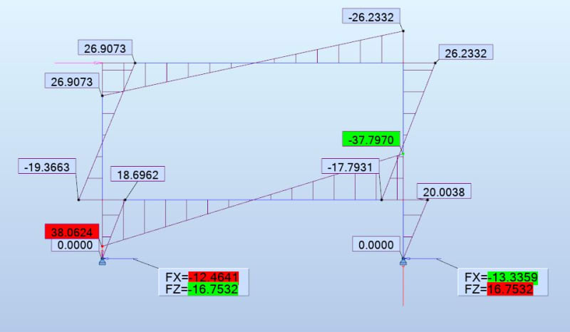

I keep getting a moment of 22.6 KNM whereas using the prokon frame analysis module I keep getting around 32.

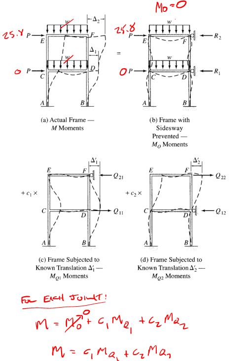

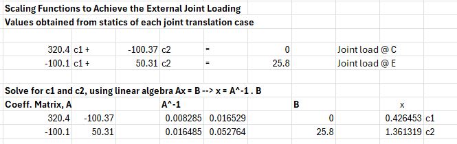

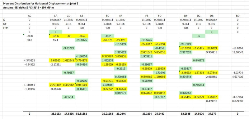

I analysed the frame without the sway correction as of yet, but I genuinely do not feel it would amount to such.
I have tried introducing points of contraflexire between the rigid joints but can’t seem to match the software analysis.
Kindly let me know what I am possibly doing wrong.
