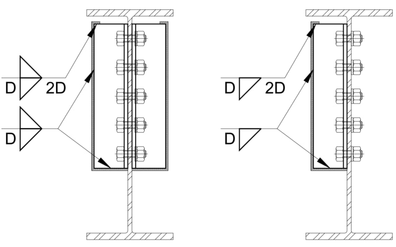

I believe the issue is the "rotational ductility" aspect of AISC simple shear connections. Meaning, if they are too stiff then they won't behave like a simple shear connection.
The AISC code provision is J1.2: Simple Connections:
...Flexible beam connections shall accommodate end rotations of simple beams. Some inelastic but self-limiting deformation in the connection is permitted to accommodate the end rotation of a simple beam.
Thanks Josh... well aware of that. My response was predicated on 'my' use of end plates. I would never use them for shear only connections, hence my being unaware of any code restrictions on maximum thickness.
By attaching the end plate to the full W section, you are inviting attracting moment. I might use a partial height end plate (for shear only). I'm not aware of a condition where I would use an endplate as shown, except maybe for torsional loading. In that instance I would design the connection as required. For a normal shear connection, I would likely use a couple of clip angles as shown below:
The detail is from an Adobe 'rubber stamp' I made up to use on shop drawings I review.
I use shear end plates from time to time. To ensure enough rotational flexibility, I check the AISC Manual (16th) Equation 9-52.
Like in your double and single angle figures above, the idea is to ensure the end plate can bend out of plane to allow most of the simply supported beam end rotation develop and avoid a beam end moment.
