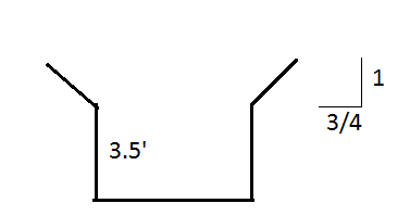

1). This is a huge concern. Grade beam is acting as a retaining wall as built, and while removing some soil on the left side will reduce lateral pressure, it will also reduce the weight of the soil on top of the footing. This soil is what helps with overturning and reducing eccentric loading due to moment frame kick out. It does not help that concrete contractor went ahead with taking the old slab out, and now hairpins are exposed and nothing ties 2 ends of the moment frame together, so foundation alone is handling the kick out, which it was not designed to do.

3) With the footing at a depth of 8', will be hard to avoid superimposing slab load on the footings. The slab is so close to the building.
I don't see it as a major problem at that depth, slab loading is low, << 1 kip / ft2, and that will have been somewhat distributed at that depth.

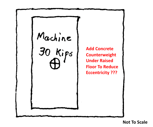

A potential solution to both of these issues could be to use the isolation slab for only the 6' x 12' machine:
1) Slab may be designed so that centroid of the machine aligns with centroid of the slab... virtually eliminating eccentricity. Important to make the alignment to the machine's centroid, which is not necessarily the the center of the machine's footprint. Doing this could require either an elongated or trapezoid shaped isolation slab.
2) Operations & support equipment would no longer be on the isolation slab.
Also, I suppose this proposal could result in some cost savings compared to a larger, more complex slab.

seriko12 - Hmmm, always more complicated than expected. No operator present takes away my second concern.
Since soil bearing pressure for the slab is low, additional weight is not a big problem. Would it be practical to add concrete counterweight to reduce eccentricity?
[idea]
I see, you mean a removable counterweight on top of the slab. that should be doable. Any vibration related issues with the gravel fill extending all the way from the wall and under the entire thinner slab on the left?

seriko12 - I was thinking of a permanent counterweight (to reduce chance of vibration), but trying a removable counterweight is probable a better idea. I did some rough calcs, concrete counterweight will have to be pretty large but should be able to remove all eccentricity.

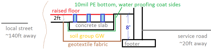

So lets say we have a 2ft or so of well compacted GW gravel covering entire area and then 1 common slab taking most of the area (partition walls, personnel, non-sensitive equipment), 1 isolated thickened slab (sensitive equipment), and 1 smaller thickened isolated slab (noisy equipment such as air compressor and water chiller). The biggest concern is low frequency vibrations - 10 Hz and under, and especially < 5 Hz. Would not those propagate through the gravel?
Regarding waterproofing, I am afraid that vapor barrier might not be enough. It works well with damp soil, but in this case, entire slab will be below water table. Any recommendation on the next most cost effective solution? Some sort of a continuously sealed membrane which could be put directly on gravel without adding a mud slab first would be ideal.

From this information alone, I assume "good" soil is where the existing footings are located... 8 feet, or so, underground. For a "best efforts" project, I would say the gravel backfill should be that deep, otherwise, chance of a successful vibration isolation slab are "low". Of course, excavating to a depth of 8' will bust the budget and collapse the existing building.
Also, the project needs input from a geotechnical engineer and a vibration isolation consultant, but the budget does not allow for that expense either.
What are the consequences of staying within budget and having a project that is a failure? Seems it is time to discuss the situation with the client.
Concerning vibration < 10 Hz, the question is not will vibration at those frequencies propagate through gravel... I'm sure they will, but well graded gravel is as good as it gets for a high subgrade modulus. The real question is how much vibration transmission is acceptable?
Waterproofing is a relative term. We used bentonite based liners and sheets to "waterproof" ponds and below water table structures. Permeability for those product is really low, but not zero. Moisture removal, or accepting that there will be some moisture accumulation are reality.
