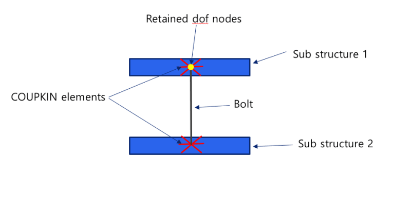

i have seleted the nodes of bolt ends as retained d.o.f nodes which are connected to COUPKIN elements between the CASE and Housing parts..
But after generating the substructure i imported the part in the new model but the sub structures are not connected at the specified bolt connection nodes.
if i try to submit the data check it is showing the unconnected regions are present in the model..
Is there any way to connect the two substructures at the Bolt and COUPKIN connections
Pleas refer the schematic of the assembly.. i have multiple bolts hence multiple retained nodes
If the blue parts are substructures then you have to retain their nodes to which the COUPKIN elements are attached.
okay what about the bolts.. will it be part of substructure 1 or sub structure 2
and once i run the generate substructure step and import the Sub_Z1.sim part file the COUP KIN elemensts assosiated to retained nodes are not present in the model
It depends on which parts of the model you want to treat as substructures. If only the blue ones then the rest should be treated as standard parts and added in the second analysis (substructure usage). If the bolt is also to be treated as substructure then you should perform a separate substructure generation f or it, retain its end nodes and then connect them with blue parts via COUPKIN elements added in the substructure usage analysis.
okay i have generated substructures for both the blue parts and bolts are considered as standard parts... but once i import the .sim files the substructures are not connected to each other and the COUP KIN elemenst are missing in the model why is it happening
You have to connect them manually (via COUPKIN elements in this case) in the second analysis using the retained nodes (defined in the first analysis).
after importing how do i connect the COUPKIN elements of Sub strutures 1 & 2 to the bolt end points
which means i have create manually the COUP Kin elements in abaqus CAE to connect the bolts ?
Actually, we are talking about COUPKIN elements but there are only distributing coupling (DCOUP) elements in Abaqus. You can define them in the second analysis but it's advised to use distributing coupling constraint instead. You could also use kinematic coupling or even rigid body constraint depending on your needs.
