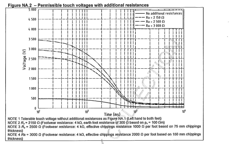

If step and touch potential are safe,Why many utility ask for low grid resistance 1 Ω or less for transmission substation?

BS 7430:2011 Annex A (informative) Guidance on typical HV/LV interfaces.A.2 Legislation:
The Electricity Supply Regulations (replaced by The Electricity Safety, Quality and Continuity Regulations in 2002) required that where in a substation the HVequipment earth and the LV neutral earth were common, that the resistance to earth has to not exceed 1 Ω. For most substations this value was provided by the un-insulated protective sheaths of the older types of cables in use and was normally sufficient to lower the impedance of these cable sheaths to ensure sufficiently low earth potential rise (EPR) for general combination of HV and LV earth systems even with very high earth-fault current. However this simple requirement is no longer adequate. The current advice of the Health and Safety Executive is that touch voltages should not exceed curve the recommendations of BS EN 50522, National Annex NA.2.
