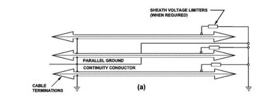

Thanks for reply. I was able to get my hands on IEEE Std 575 which has a lot of good info.
One thing I don't quite follow in the standard is how they define multiple single point grounding. I'm used to terminology of "grounded at one end" or "grounded at both ends" when it comes to discussion about grounding of MV cable shield.
The single point grounding makes sense but when the standard references multiple single point grounding, to me that is the same as grounding at both ends?
For example in the attachment from figure 3 of standard it references this as "single point grounding" but looking at figure it appears to be grounded at both ends? If so this appears to suggest that even with grounding at both ends a separate ground conductor is recommended.
Perhaps I'm missing something here as it relates to terminology and use of ground conductor? Single Point Grounding.JPG

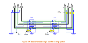

I believe multiple single-point grounding can also be called sectionalised single point bonding, please see Figure 2.4 from CIGRE TB 797 below:
The sheath voltage limiter is essentially 'open', like a surge arrestor, so only one end of the cable is directly grounded. The sheath/shield is not normally grounded at the SVL end, unless there is a fault/transient. CIGRE TB 797 has some good explanations of the different cable bonding/grounding systems.

I agree with ema.
The shield is grounded on a single point- at one end or in the middle [in order to reduce 1/2 of the build-up voltage].
On the other end there are limiters only [surge arrestors]
They act only if the built-up voltage is too high.
The build-up voltage is the product of the current flowing in the main conductor by reactance between the main and shield.IEEE 575 shield grounding.jpg

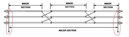

Thanks for the responses, very helpful. No what I understand the figure and reading through the standard it appears that the standard only addresses single point bonding and cross bonding but not an application where the shield is simply bonded to ground at the end of each cable run.
It appears that cross bonding is similar to having cable grounded at both ends only difference being the cross bonding between sections and not just bonding of each end of the same cable. Is this standard geared more towards utility applications and thus doesn't address a cable being bonded at both ends (wihtout cross bonding) as is typical in industrial applications?
Also is the only difference between single point bonding and multiple single point bonding, that multiple single point has the GCC cable and voltage limiters, but still only has shield directly bonded to ground at one end?
If there are 3 single core cables [three phases in flat arrangement] divided in major lengths and each major length divided in three identical -minor-lengths, then if each minor shield length is connected with other two phases the total build-up voltage per major length is zero-sum of three 120 degrees distanced vectors.
Then, you may connect each major cable length shield both ends to ground [no build-up voltage,IEEE 575 shield cross bonding.jpg no losses].
So it seems like cross bonding is essentially bonding at both ends which results in no build up voltage and also does not cause reduced cable ampacity due to circulating currents with shield bonded at both ends.
When cables are not sectionalized for cross bonding and are only a single run end-to-end then it seems like bonding at both ends of cable are only option for reducing voltage build up, but must account for circulating currents? In such a case is still standard to run a GCC along with shield?
Is there a reason why this standard does not discuss bonding at both ends for a single cable run?
What you are saying about cross bonding is correct, however, cross bonding can be difficult to implement due to geographical/space and cost constraints.
From my experience it is not standard to run a GCC as long as the sheath/shield has adequate fault performance.
Also, the introduction of the IEEE 575-2014 implies that 'special bonding techniques' are methods that reduce the derating of cables due to heat losses incurred via circulating current in the cable screens (which occurs in solidly bonded cables). So pretty much special bonding techniques is anything that is not single point bonded.
For both ends grounding case this standard recommends calculation of shield losses following IEC 60287-1 and then including this with main conductor losses and dielectric losses to recalculate the conductor ampacity following this IEC standard also.
There are already calculated tables in most of engineering handbook of almost each manufacturer and in standards as IEC 60502-2 [Annex B] for up to 30 kV cables.
In connection with the shield short-circuit withstand current is the standard ICEA P-45-482-1994 SHORT CIRCUIT PERFORMANCE OF METALLIC SHIELDS AND SHEATHS ON INSULATED CABLE
According with this standard, the allowable short-circuit current level in shield -or concentric neutral-may be different than the short circuit current in main conductor-even full concentric neutral, nevertheless, the start temperature is less but the maximum allowable temperature may be also less than conductor insulation. If the conductor insulation is XLPE or EPR the maximum temperature may be 250oC, but for jacket -if the material is thermoplastic-maximum temperature may be 200oC only.
