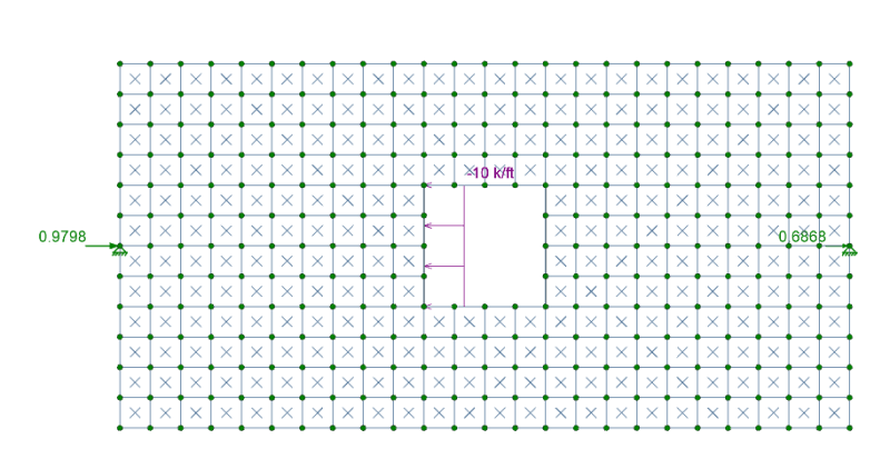

This is what I was trying to say. Assuming a deformable steel plate and rigid point supports at each end, the load is more direct to the left support and the reaction will account for that. I believe this is what muruep00 was asking and without any other variables thrown in.
haynewp, if you replace the pin at the right end with a horizontal roller, how far does that node move in the model? My guess is it's an extraordinarily small distance.
The next question is whether there's enough slop in the system for either end, or the bolt in the middle, to move that far without engaging and beginning to deform elastically.
In my quote above from the old Plastic Analysis course, that's the kind of thing they had in mind.

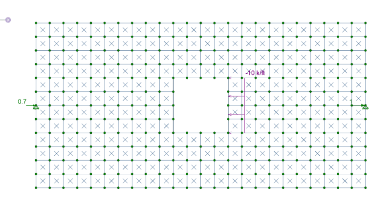

also, I`m wondering if more load goes to the left because the load is applied closer to the left. Do the results change if you a) apply the load the the right side of the opening, or b) reduce the length to the right side such that the load is centered between the supports?
-0.0067 inch based on what I happened to throw in this model I made in 3 minutes.

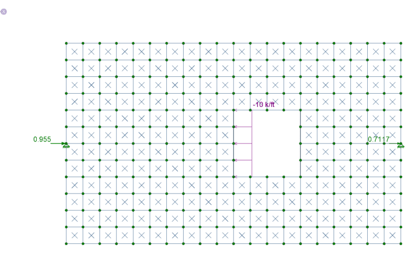

Increases to the right slightly as expected, less length so increased stiffness.
That's what I'm talking about.
That displacement is microscopic. If there's 0.007 in. of slop in either the left or right end, then ALL of the force will go to the other end. Instead of 0.9798 kip on the left end, it might be 0.9798 + 0.6868, which is 70% higher than the elastic analysis calculates.
The smaller the parts, the worse this seems to be. That's one reason FEA for steel connection design stands the hairs up on the back of my neck.
Ultimate strength analysis methods like plastic design or yield line analysis have a lot better chance of being accurate. In most cases, I think we use elastic methods because our tools are set up for them, not because they represent an accurate calculation. I think our industry places too much faith in them.

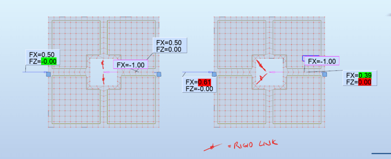

Haynewp:
Your load is not centered so is more or less giving the same result as a standard mechanics of material formula would provide. For a concentrated axial load located anywhere on a span the fixed end reactions are:
Ri = P (a-L) / L
Rj = -P a / L
For your setup I just counted squares which gives a = 10 and L = 24
Ri = P (10-24) / 24 = -0.58334 P
Rj = -P (10) / 24 = -0.41667 P
Your model total P = 0.9798 + 0.6868 = 1.6666 * -1 (load pointed to the left)
Ri = 0.9723 (to the right) relative error of 0.765 %
Rj = 0.6944 (to the right) relative error of 1.1 %
