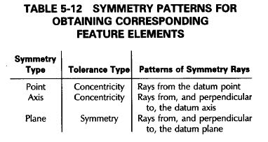

Y14.5.1-1994 para 5.7 said:
Concentricity is that condition where the median points (centroids) of all diametrically opposed elements of a figure of revolution (or correspondingly located elements of two or more radially disposed features) are congruent with a datum axis or center point. Symmetry is that condition where one or more features is equally disposed about a datum plane.
A concentricity or symmetry tolerance specifies that the centroid of corresponding point elements on the surfaces of the actual features must lie in some symmetry tolerance zone.
Corresponding point elements are obtained by intersecting a pattern of symmetry rays with the actual feature. The rays of symmetry are determined according to Table 5-12.
Thus for a width-shaped feature I can get behind the statement Kedu referenced from linkedin "because DMPF is only form, so orientation is self-referencing, and symmetry is form and location, so orientation is externally referenced". This is because DMP flatness and symmetry would theoretically be equivalent if the referenced datum feature for symmetry was the feature itself (self-referencing) as the datum plane referenced in table 5-12 would simply be the UAME center plane.
This is a result of the fact that for a width-shaped feature the centroids/median points of the rays for symmetry would create a similar imperfect (abstract) plane as the center points of all line segments for a derived median plane - the main difference being that the reference to which these rays/line segments are normal to is external (symmetry) instead of internal (DMP flatness).
This relationship does not carry over to concentricity and DML straightness as the center points of "rays from, and perpendicular to, the datum axis" and the center points of "all cross sections of the feature" do not create analogous geometry. Simply put, the symmetry definition would evaluate multiple center points of rays at each cross section from which a derived median line CANNOT be extracted whereas DML straightness of course evaluates a single center point at each cross section from which a derived median line can (and must) obviously be extracted.

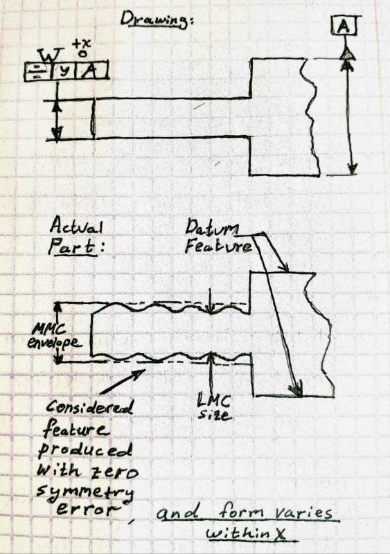

Suppose that a feature is specified with a directly toleranced dimension and a symmetry tolerance. Can its form vary within the bounds of the envelope of perfect form at MMC by the entire size tolerance without any additional restriction? If yes, the symmetry tolerance does not add any restriction on the form variation i.e. it does not control form.
Edit: The figure is intended to represent a situation that all median points along the considered feature form a flat plane centered to datum A.

In you illustration, what do you mean by "and form varies within X"? Which feature's form variation do you have in mind?
pmarc,
I mean the surface variation, not the variation of the theoretical surface formed by the median points related to the symmetry tolerance. I know that surface variation is not what symmetry controls, but I think that for the purpose of making a decision whether or not symmetry can be considered a form control (which is not how the standard classifies it), all types of possible form restrictions should be considered.
The symmetry "form control" of imperfect resolved geometry aspect needs to be addressed too.
I know that DMP flatness does not control the surface variation either, and symmetry can easily be thought of as limiting the imperfect resolved geometry variation but - there is a fundamental difference: DMP flatness overrides rule#1 and becomes the sole form control where no other form controls are specified. Symmetry overrides nothing and depending on its tolerance value and the size tolerance value it may or may not have any influence on the form variation. As such, I don't think it can be considered a form control.

The fact that DMP flatness overrides rule #1 is an interesting notable difference, but it does not change the underlying principle which is common within the two controls. It just means that the form deviation allowed by symmetry is limited by rule #1 even if the symmetry tolerance applied is greater than MMC-LMC, unless the Independency symbol is applied.
Again, I already showed how a self referencing symmetry control would be identical to DMP flatness. This influence on form deviation would not be any greater or less than DMP flatness. If the tolerance applied were greater than MMC-LMC, then all one would have to do is apply the Independency symbol to symmetry and they would again be identical as symmetry does not by default override rule #1.
Another way to look at it is that the form deviation allowed by rule #1 is unaffected by the symmetry control when the symmetry tolerance is greater than MMC-LMC, unless the independency symbol is applied.
It would be so if the symmetry control:
1. Would be allowed to be self-referencing.
2. Would override rule #1 and not require the independency symbol to act the same.
3. Would be required that when used in conjunction with an orientation tolerance, the symmetry tolerance must be smaller.
4. Would be allowed to be applied with an MMC modifier.
That is a lot of "woulds".
DMP flatness comes with all sorts of auxiliary rules that indicate that its role is to control form. Symmetry comes with none of them.
