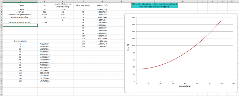

i want to get the system curve of a pipeline , i ask about the method,i calculate th loss for fixed flow rated and i use the formula : PDC = a * (Qv^2)to get the curve.
with
PDC is the losshead in the system
Qv is the volume flow rate
when can i use yhis formula ?
is there any other method ?

you calculate for various flowrates below and above the fixed flowrate, and then plot the curve from this data.

In simplistic terms
PDC = Hl + ( a * Qv^2)
Where Hl is the static head loss at zero flow or any sort of static pressure at your end point converted to head.
Also whilst pressure drop is proportional to flowrate ^2, it is not a precise curve as Re no changes.
In the example given above , Hl is about 34ft.
In low head systems something like the difference in liquid level in a tank at the end point can change your system curve enough to make a difference.

You can convert your single calculated point to a curve using the following formula:
H = [(PCD - StaticHead)/(Qv^2)] x F^2 + StaticHead
Where
H is head of fluid as a function of F
F is flow
StaticHead is your lift and/or tank pressure
PCD is head at your single calculated point
Qv is flow at your single calculated point
You can find your operating head (H) for any value of F by curve-fitting the pump curve to a 2nd order polynomial and setting the two formulas equal to each other then finding zero. Then use the quadratic equation to solve for F. Plug F back into the equation above to find the corresponding H.

Well, repeat the calculation for another fixed flow rate, and keep doing it until you can make a nice graph, from which you can estimate your coefficients.

Using Mike's method, you only need 3 points because it will be a second order polynomial. You only need to calculate 2 points because they can be mirrored about the head axis.
