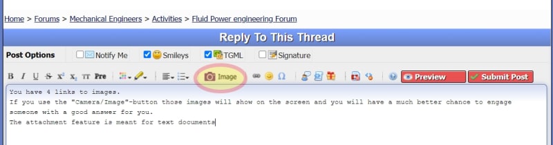

You have 4 links to images.
If you use the "Camera/Image"-button those images will show on the screen and you will have a much better chance to engage someone with a good answer for you.
The attachment feature is meant for text documents
