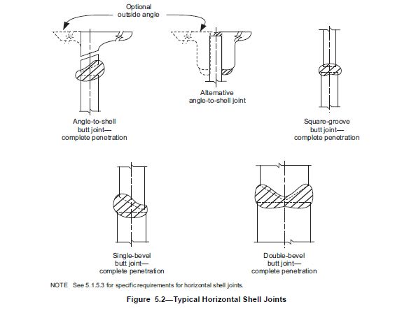

Dear Experts
Para 5.1.5.3 of 2020 Edition says "Unless otherwise specified, abutting shell plates at horizontal joints shall have a common vertical centerline". I am trying to understand it, but my relatively little experience in Tanks makes it difficult to understand. Any good Samaritan can help me to understand this , if possible with a picture
Pls look (Figure 5.2—Typical Horizontal Shell Joints ).
Notice that the vertical centerlines of shell plates at horizontal joints matches and have a common vertical centerline.

While the default unless otherwise specified is center stacked, it is not uncommon for owners to specify shell plates to be inside aligned (flush inside) if there is to be a floating roof.
