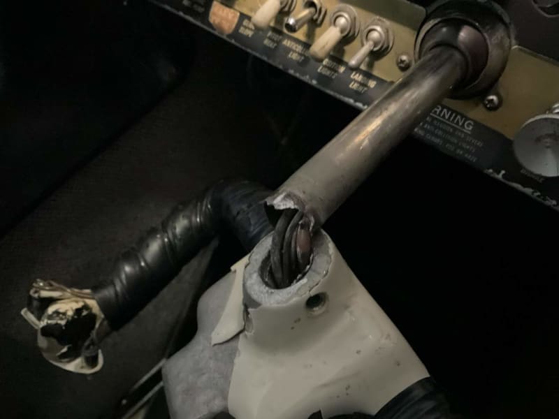

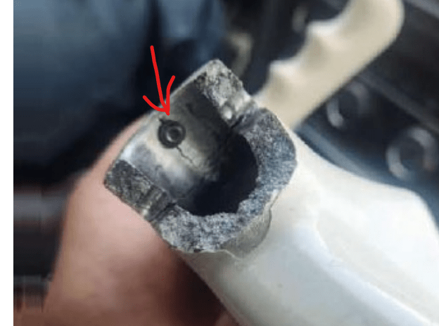

In particular, tubular shapes of relatively thin wall thicknesses. Effecting a single precision tapered / reamed hole in such material and specific configuration, could not / would not maintain the controlled interference fit expected / required over time. In this case, stress corrosion fatigue and eventual fracture of an investment cast aluminum flight yoke integral stub boss secured to a cres steel tube via a single taper pin and nut. Cres tube slip fits inside the flight control yoke stub boss. The fractured off stub exhibits an axial stress corrosion crack (grain dark gray to black in color) emanating from the I.D. of the boss
on one side of the radial fracture terminated by overload brittle fracture ( grain light gray color) on the other side.
Dissimilar metal corrosion
is also suspected as the taper pin and it's nut remained attached to the cres tube and exhibited loss of cad plating thru out most of its mating surfaces. Additionally, it seems re-torquing the taper pin nut over many years so as to maintain interference fit and thereby eliminate cumulative "play" would tend to expand the stub end cast metal beyond its Fcy property. I could not find any guidance / standards in any publications so far, including Boeing's taper shank fasteners in aluminum structures, documemt# 6m54-153, McDonnell Douglas process standards (DPS), Michael Niu's publications, NASA. Thank you.

In this case, the cast Al yoke fractured off in the pilot's hands but cannot confirm whilst in flight or on the ground.

Is this a set screw?

Looks like a setscrew for certain. Images at
Putting a collar on that with a custom nut to grab the taper would be an easy repair. Add a clearance hole for access to the setscrew. A few bucks more to round the corners of the collar instead of squaring it off or chamfering would keep with the rest of the look; paint to match.

Mint Julep; it does indeed appear to be a set screw that may induce additional radial stresses in the cast aluminum element of this assembly, leading to eventual fatigue, although i cannot confirm.

AD 77-17-04 appears to be a possible cause for the problem as the tapered pin and set screw get messed with every time.
