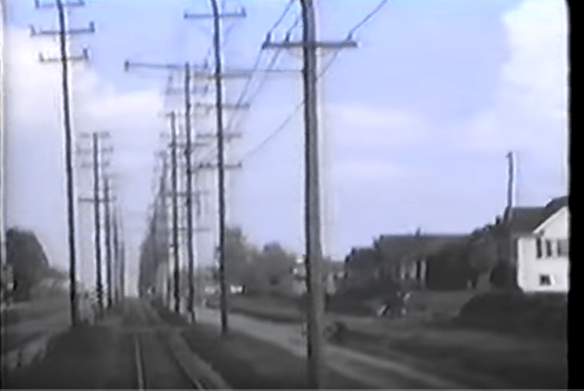

Here is a screen shot of a video taken about 70 years ago.
You may see multiple transmission circuits as well as some local distribution along the interurban right-of-way.
Vancouver B.C, First Ave and Slocan street, looking east. Circa 1950

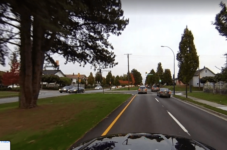

Vancouver B.C, First Ave and Slocan street, Google Maps.
In the next block is the start of a local distribution circuit coming in from the south.
The multiple transmission circuits are now buried under the original ROW.

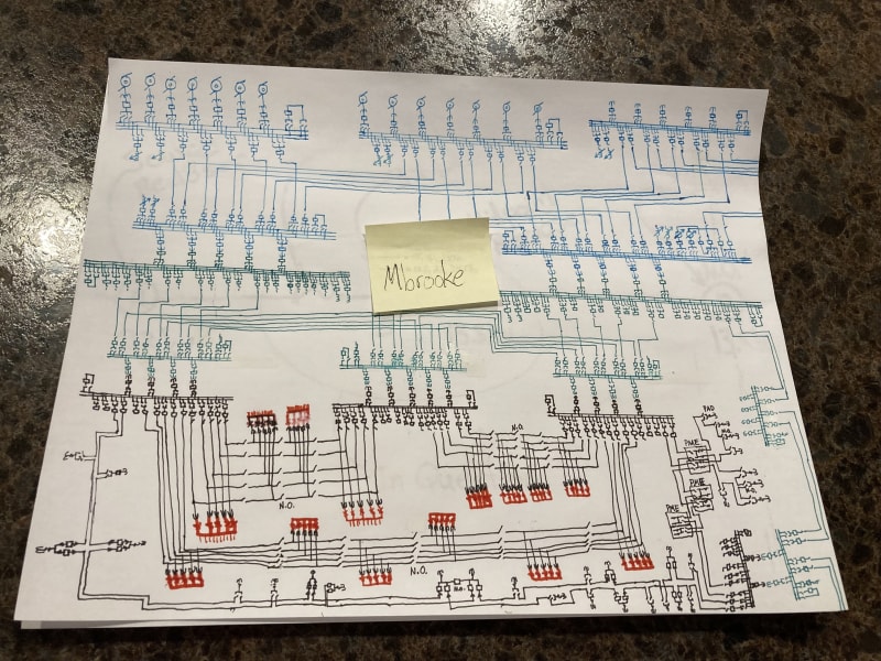

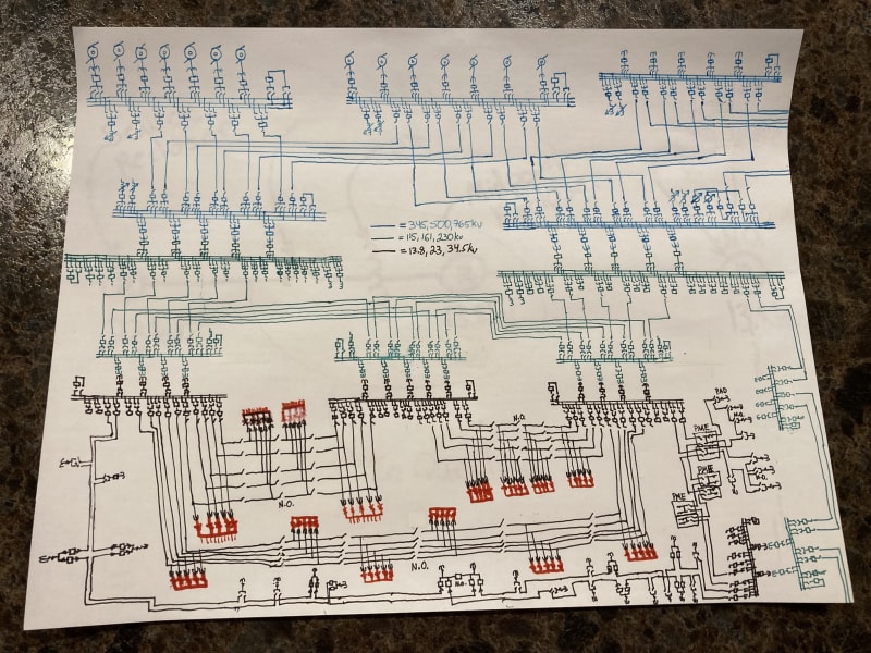

If curious, here is a rough sketch of the system I envision:
Credit sticky:
GIS housed in a brick building, grates for transformer vents, metal doors for equipment replacement.
The problem is not to build in-door substations, the problem is more the vast amount of capacitive apparent power needed for the high and medium voltage cables. Therefore the length of these cables has to be limited.
The usual approach in Europe is to use HV cable only for radial feeders reaching into the city center from the periphery. These feeders are supplied from a ring of overhead lines in the outer quarters.
This approach combines the benefits of both ways of lines in an optimum way and avoids unnecessary invest (doing all with cable) as well as unacceptable congestion and reliability issues by overhead lines in densely populated areas.
This concept is proven for decades and expect that its use will pertain although some researchers a promoting DC-distribution as alternative.
Would reactors at each substation be enough to mitigate this?
