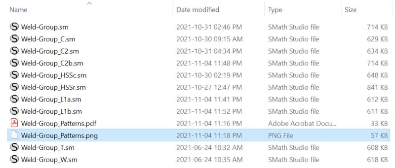

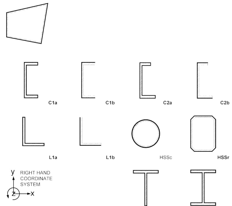

I'd go for SMath... but it will require coding and will be your own suite... almost anything I design, if there are going to be three or more uses of it, I code it up in SMath. I use the coding to think about the application. A downside, and I don't know how to accommodate it is that I now have hundreds of programs and sometimes it is difficult to find the one I'm looking for and I generally give them fairly good names). With SMath I do a lot of 'cut and paste'.
An example for welding patterns using SMath and the directory system I use
diks,
I assume you know enough in the file name to search with explorer for files that match the "profile" of what you are looking for. That won't find the programs your trying to find? I know at times it won't find one I know is there somewhere. When it does not find it, I have an old trick from the DOS days that still works. Go back in time to punch cards and then back forward one year.

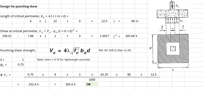

The last company I worked for did a great job with Excel spreadsheets. Look up tables and drop down lists and such. All their commonly done calcs were in Excel. It was really cool. But, seemed like it would be a pain to set up.

I don't use the Tedds Word integration because I might stop using Tedds one day. I use Excel without Tedds and still do WYSIWYG type stuff. I haven't used MathCAD or other similar software because ETABS (which I use extensively) exports results to Excel. Excel is a bit janky, but readable. And VBA does its job when needed.
