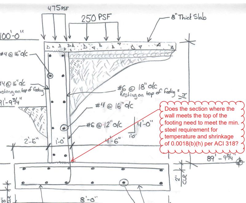

Hello,
I am designing a retaining wall and the concrete needs to be designed according to ACI 318-14. Please refer to the attachment for a general sense of what I am talking about. However, my specific design has different dimensions and loading than shown in the attachment. The vertical flexural steel at the back face of the wall stem that is anchored into the footing is adequate for the moment demand in the stem but the area of steel where the top of the footing meets the base of the stem does not meet the requirement of 0.0018x(gross concrete area). As shown in the attachment, I plan to have vertical steel in the front face of the wall resting on the top of the footing to meet the min. temperature and steel requirement for the stem. Do I need more area of steel crossing the plane where the stem meets the footing to meet the temperature and steel requirement at that specific location?
EIT
 https://files.engineering.com/getfile.aspx?folder=001f488b-bdf6-447e-8d2a-758614491ece&file=Retaining_Wall_Question.pdf

Thanks for your response, I was specifically talking about the vertical rebar in the stem of the wall that crosses the plane at the top of the footing. I only have one set of bars crossing that plane but as soon as you go up the stem, I have vertical bars on the front face and the back face of the wall.

I'm confused.
You have enough steel to meet your flexural demands for your main vertical bars, but this does not meet the minimum temp & shrinkage requirement for the stem.
But.. you are adding a second vertical curtain of steel on the front face of the stem. Since temperature and shrinkage steel can be located anywhere in the cross section; shouldn't the combined front and rear curtains of vertical bars get you over the threshold; so you are good to go? (i don't think it matters if the front bars cross into the footing)
Temperature and shrinkage steel requirements for a cantilevered retaining wall would be for the horizontal bars. Vertically, the concrete is free to shrink. You need to provide flexural reinforcement at the tension face (rear face) of the wall, and that may or may not be the amount you proposed.
Hokie-
You're right..that front face vertical bar is really there just to support the horizontal bars prior to casting.
I'm thinking this must be short wall if the main tension face flexural steel does not exceed the temp & shrink value.

You need more vertical flexural reinforcing on the tension side to meet the code minimum. Then you also meet the letter of the code for T&S although there's usually not much problem as Hokie said.

On stem of retaining walls,
1. the amount of soil side steel is determined by strength requirement, thus it follows the rules on minimum flexural steel requirement. The basic form been ρ[sub]min[/sub] = 200/fy, and the As is placed in the tension side of an area b[sub]w[/sub]*d. Strictly speaking, the flexural reinforcement shouldn't be considered serving the purpose of T/S control, but practically, I don't think anybody has ever added T/S steel on top of the flexural steel.
2. unless designed as compression member, per code, no front face reinforcement is required. But many designers prefer to place reinforcement per code minimum requirement. However, the amount and the location of placement are confusing, as for slab, ρ[sub]T/S[/sub] = 0.0018, and for wall, ρ[sub]min[/sub] = 0.0015 (V) and 0.0025 (H). As I recall, the minimum steel is to be placed in the area b*h, but the code does not address the location/method of this placement, it can be one layer in the middle, or two layers, one each face, again, it is a judgement call by the designer.
The question of the OP is concerning the necessity of the front face vertical bars develop into the base slab. IMO, yes, to better protect the toe of the stem, but it is not required by code.

OP's question is not limited, or even primarily about, the front face bars as far as I can tell. Rather, it's about whether or not the total quantity of rebar crossing the joint is sufficient. And it's not unless it's in the neighborhood of 0.0025 or possesses more than 1/3 reserve flexural capacity in my opinion.
Let's make it simple,
1. There is no argument that the flexural reinforcement must develop into the base slab.
2. If classify this is a structural wall, the front face bars also must develop into the base slab, but I doubt the justification on this classification, and obviously the OP did not.
3. Code does not mandate the development of T/S steel, but the designer shall make call based on the effect desired. It can go either way, I'll develop the T/S bars by practice, not per code.
