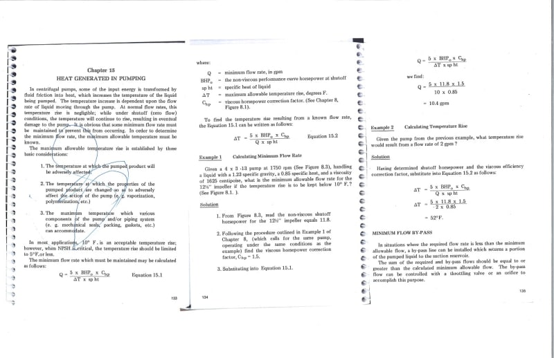

Before the internet, the Durco Pump salesperson would give you a copy of the Durco Pump Engineering Manual which has the formula. Now, if the Durco Pump salesperson doesn't give it to you on a thumb drive or attach it in e-mail, you have to buy it from Amazon or eBay or someone.
Or, you can use Search in this forum. Top, left, between Forum and FAQs. Here's one hit I got - thread407-3427 .

Durco Pump Engineering Manual.
The Duriron Company
Edited by R. E. Syska and J. R. Birk
Good Luck,
Latexman

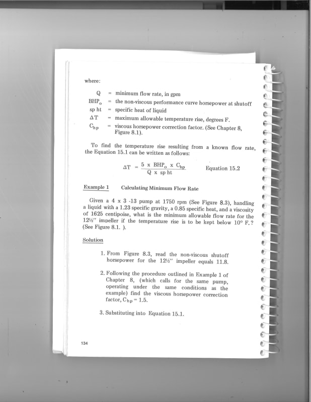

Hi Latexman,
Can I please post couple more pages form the Durco Engineering Manual after the page posted by you. I wanted to see the units used in the example problem.
Thanks and Regards,
Pavan
Well what this is a rise in temperature for a pump taking 10hp with NO FLOW.
It is a very simplistic calculation asusming all the shaft power is going into heating up the fluid (water) which is held within the pump casing.
Your original post talked about something completely different.
So what are you trying to find?
In terms of heat input into the water all you need to do is find the shaft power at whatever flowrate you want to study, find the efficiency of the pump at that flowrate and then conservatively assume that all the inefficiency is going into heating up the water.
So e.g. if you have a shaft power of say 100HP and a pump efficiency of 70% at that flowrate then asusme 30hp is going into your fluid. Your flowraste is say 100 GPM.
So I reckon this is about 0.2 F rise.
The whole Chapter 13:
Please pardon, one of my kids drew on it a long time ago.
Good Luck,
Latexman
