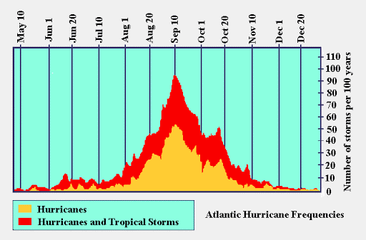

In Florida, there is another step to take (if possible) that will greatly reduce the odds of a high wind event. Do not schedule the event in July, August, September or October, prime time for hurricanes and tropical storms:
[idea]
@SRE....Yep. You nailed it as usual!
