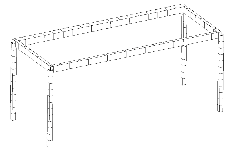

Hello,
I see that the discussion has continued while I was offline. Interesting, and I appreciate it.
Like I said before, it is a very simple structure in terms of geometry (figure of beam model below):
The walls and the roof (not in the picture) are made of glass and the floor (also not in the picture) is similar to the roof with some secondary beams supporting the exhibit.
Since the roof is lightweight the forces from an earthquake will be small. I also suspect that the windload in Florida for this structure will be worse that the earthquake in California.
The ULS utilization is < 50% due to other requirements.
An earthquake should not be an issue, partially due to probability but also due to low utilization. My concern is the detailing.
Wind, well an hurricane does not appear "just like that", there will be warning. So we can either anchor the structure to the ground, close it from people. Or simply move it indoors.
Regarding the use of Eurocode. I have actually to some extent used non-linear FEM-analysis as described in the Eurocode. One reason is the handle different national annexes by not using the standard design "formulas" but rather something more general. I don't know if that is possible in the US.
Thomas

I agree that engineering judgment is required but technically ASCE 37 isn't a referenced document in the building code (IBC, Florida or California) so it's not a guarantee that a bldg dept would accept it for a permit. If a permit isn't required then by all means go ahead and use it. The intent is still there to make sure the structure won't endanger the public.
The Florida Building Code and the California Building Code are both based off the IBC and so they both have the same section 3103 for Temporary Structures constructed for less than 180 days. Section 3103.2 says that 'a permit application and construction documents shall be submitted for each installation of a temporary structure.' My understanding of Section 3103 is that Temporary structures have to meet basic strength requirements and not the serviceability or ductility requirements so I think it boils down to the same thing everyone has been talking about already. It's just a matter of taking a different route to get there that I think would be more acceptable to a building dept.

I get the impression that the answer to my question is less clear-cut then I expected. Let me explain how it works with Eurocode.
You have a design wind velocity (50 year return period). Then I use the Eurocode for loads during execution (EN 1991-1-6). If the structure is used less the 3 days, I can use use a 2-year return period. För > 3 days bur less than 3 months I can use a 5-year return period. That means 50 year velocity x 0.855. Since the pressure is proportional to velocity squared I have ~75% of the wind pressure.
Accidental loads are (as far as I know) not considered in this case. And since the structure is lightweight the forces from an earthquake will be small if I include them.
If I use this approach and can show low stresses in the structure, do you think that would be acceptable?
Edit: An additional question, does this type of structure require a stamp from a PE? Perhaps this is obvious but in Europe there are different approaches depending on the country.
Thomas
I think that's acceptable. Sometimes what I do is just design for the full wind/seismic loading. If it's OK I'm happy, if not then I would argue the need for a reduced return period. It sounds like your structure is pretty stout and lightweight so it might be OK. If you design for the full wind pressure and it passes then you can rest assured that you *shouldn't* have any issue with a building department in getting a permit.

I wouldn't bother with trying to meet seismic detailing requirements. Which, for directly welded HSS would be fairly difficult. I'd be very surprised if any building official even brought that up.
