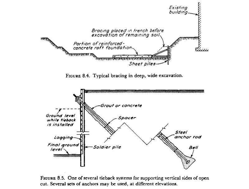

Big H - Same as PEinc, can't open your attachment.
Sorry, putting forth the discussion and figure regarding Figure 8.4:
Being in Canada, I would expect that the excavated areas would freeze solidly for a good portion of the year. If that is the case when the exposed surface are solidly frozen, there may not need temporary supports since these exposed surfaces would be as hard as rock. Just a thought and Canadian safety laws may allow. In our case this point was made clear to OSHA which agreed with us when they did an inspection of our site. Sheet piles could be an option or a bracing system of H beams which can be placed where the workers are located and which can be quickly dismantled and moved around by equipment.
