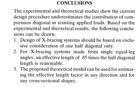

The effective length (kz) is 0.85 times the half diagonal length considering the radius of gyration in the z-axis, rz and (kx = ky = 1.0) times half length in rx and ry (see screenshot from El-Tayem and Goel). All the three limits (0.85 * (L/2) /rz), (0.85 * (L/2) /rx) and (0.85 * (L/2) /ry) to be in range of 200 to 300 (recommendation as mentioned above).

That 0.85 times half the diagonal length is consistent with the 0.45 times the diagonal length that I've used as a guide. The 0.45 came from an early publication published by one of the Aluminum suppliers.
I don't have a problem with the article, I just don't think it applies to tension only bracing as described by OP. The braces might not slap in the wind though, but they will steel seem to vibrate.
