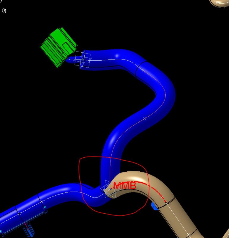

The previous user created text that is not so close to its location ( I placed a red arrow where is the right location).
I tried to move it but I can't find a way to do it.
Is there any way to do that move (without replacing the current text)?
Also, how the existing ones have been created?

They might be 3D Annotations added with the DMU Navigator.
Where do they show up in the tree?
Indeed this is 3D Text (Marker) added with DMU Navigator, the text is under application.
Not possible to move it without automation.

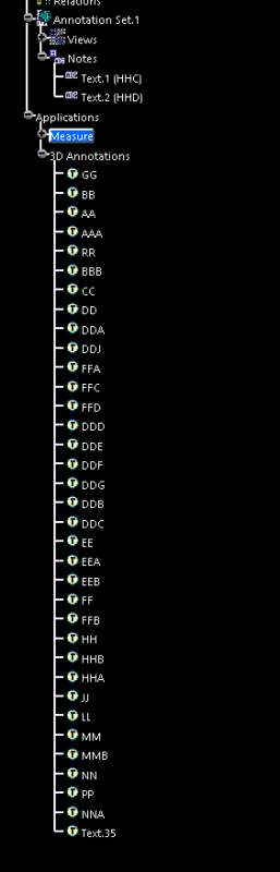

They show up at the bottem of the tree:
The last text (Text.35) has been created by me, as a "fruit" of your teaching.
