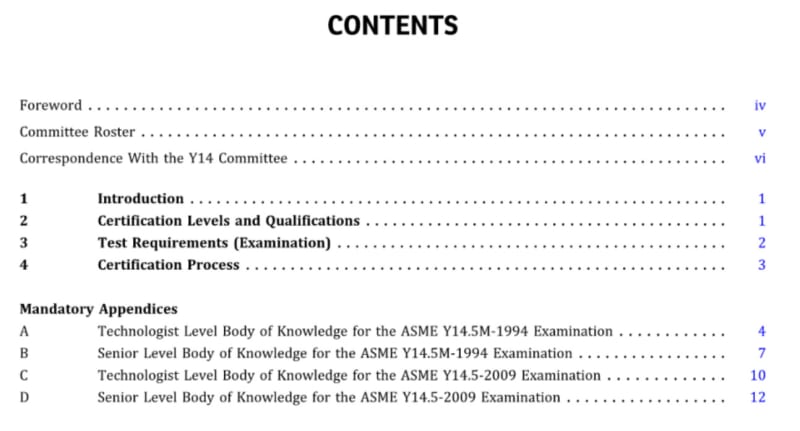

Did they open the 2018 test or still 2009 is the latest?
From the contents below, we know that 2018 test is not ready yet.
