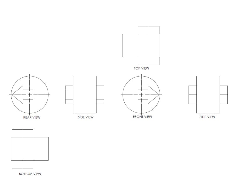

Something else I thought of. Does it mean that the example below is an allowable practice? Again, ignore the names of the views. They are there to clarify how I see the views being formed.
That is the correct way (3rd angle projection). It is what I mentioned before, it was missing the side view.

Sorry for the confusion, this example doesn't directly relate to the original question of the view missing. It is about the bottom view being placed below the rear view. Now top view and bottom view are in reverse orientation from each other.

They are reversed because the bottom view is projected from the rear view, the top view is projected from the front view.
Imagine holding the part in your hand and rotating your hand, you see the views.

3rd Angle projection is like unfolding a cardboard box. If one can refold the box so the projection is across each fold then it is fine.
1st angle projection is like rolling the part on the drawing board. If the part could be rolled as represented by the continuity of neighboring views, then the projection is fine.
This latest example would be unlikely to be allowed, not on the grounds of how it was projected, but that it is severely redundant - a separate problem.

I didn't have an issue with the fact that the bottom view was reversed. The question was more about the layout of the views. I understand that you can unfold the "projection planes box" to look like that (again aside from the fact whether it is a good practice or not) and the bottom view will be reversed.
Aside from the fact that it looks really weird to me I can only site this portion of the standard: "6.1 Orthographic views, unless removed as described below, shall be properly oriented to one another based on orthographic projection and whether first- or third-angle projection is used." The bottom view is properly oriented to the rear view in this layout but no longer properly oriented to the top view. I realize that you can interpret it as "adjacent views should be properly oriented", however the standard uses the term adjacent views in many other places but not here. It's pretty weak, but that the best I can come up with against such a layout.
